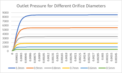

Looks o.k. so far, however if I simulate a number of different restriction diameters, I get this:
I would expect final outlet pressure to equal input pressure once the system reaches equilibrium if I have modelled it correctly - the results make me think my chosen model settings are wrong somewhere.

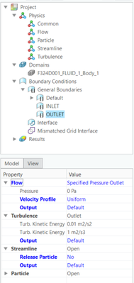

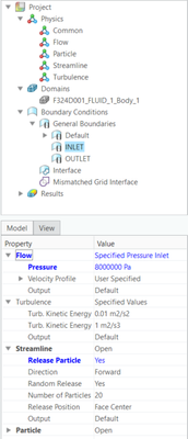

Inlet and Outlet settings are:
Inlet:
Outlet:
