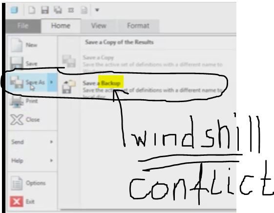

I am trying to save the animated result of a static simulation. Every website, including PTC, says to select "Movie" from the "Save As" menu. I do not see this option. How do I save/export FEA results in Creo 5?
I am using Creo 5.0.4.0 on Windows 7.

maybe windchill conflict,
please test without windchill

If you check the screenshot I posted, I do not have the option to save as any file type other than simulate results, hence my posting of this question. I have seen on the PTC support site that you should be able to click "Save As" and choose the file type for mpeg, but it doesn't show up.

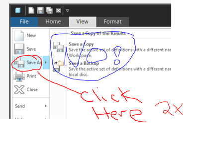

Creo is a little weird here.  Click the Save As again where I show.
Oh and correction there is a MOVIE option for AVI files.  I just never use that because it is uncompressed.
Maybe what I replied with wasn't quite clear, I have no file type options within "Save As" other than simulate results. See the image.
Did you click again where I show the red circle?  Or were you not replying to my last post.
Yes, when I say that I clicked "Save As" I mean that I clicked "Save As" and was not clicking in the wrong place. I can record a video if you don't believe the screenshot?

Hmmmm.   I will say I do not have windchill option like you have. But since your dialog matches the "Save a Copy" dialog expected I still think the weird click sequence is the issue.
I know this is really weird, I don't know how many times it has fooled me. (too many)
Weird Click sequenceWeird Click sequence
I get the same window with the same options whether I click "Save As" or "Save As > Save a Copy."
Although my "Save As" option only requires one click, and not two. Yours requires two clicks?

How about Save As, Save a backup?
Oh I see, it is because I don't have windchill that this is the sequence for me.
Save a backup also has the same two options. The other options for animations, etc. are not shown.
I would contact PTC.  I think it is related to your windchill setup but I have never used windchill.
Last ditch suggestion... Is it possible that you just need to choose a local drive location rather than your workspace and then the new file types show up?

    Hey guys, if you take a look at my previous replies and look at the screenshots I have posted, I do not have the video file options within "Save As." They just don't show up. The only option I have is to save it as a results file. Animations/Mpeg/etc. doesn't show up.
    You would find the options under Save As Backup
    No matter how many times I type "I can't see these options," my point doesn't seem to be made.
    Please look at my previous replies and attached screenshots.
