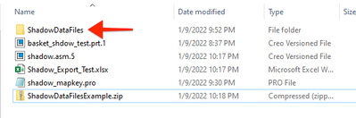

Once that was setup - I recorded a mapkey to open up the saved shadow analysis and export the data to a text file in a sub-directory. (more on that in a sec).

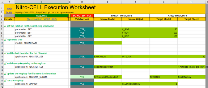

I used Nitro-CELL to setup a "batch" process for all the rotations I was interested in.
The batch sheet will loop through each variation and force another worksheet to execute with the operations (genShadow):
As you can see - this sets the rotation parameters values for the assembly offset CSYS (as defined by the active running batch item - excel formula referenced the values) - then regenerates the model.
Then it fixes the mapkey I added into excel to update the file name for the data export (row number in the batch sheet) - and then executes the mapkey to extract the shadow data to a named text file within in a sub-directory (ShadowDataFiles)
