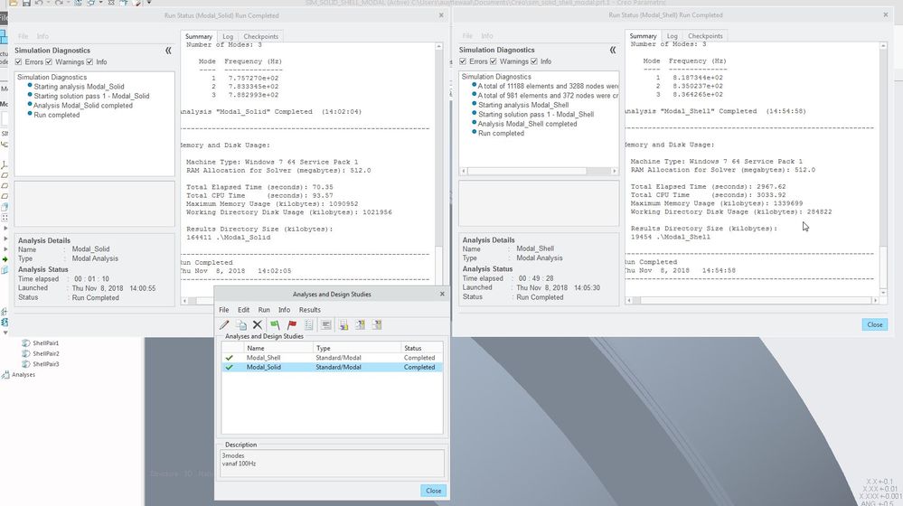

What about in modal analysis? Are the natural frequencies within 5% as your static deflection results?
Thanks in advance.
Rich Hilson
Nov 9, 2018 12:34 PM UTC
A short test for Modal Analyses with only solid versus Solid AND shell in Creo 5.0.2.0. Strangly calculation time is MUCH MORE with shells than with only Solid in this case (49min. vs 1min). Mesh settings are default and only Quickstudy is applied, so I wouldn't worry over the result difference. I'm not ready to jump into conclusions yet, but at least be alert using shells in Modal.
Nov 16, 2018 9:53 AM UTC
We found Modal Analyses (in this example) is only slow when using Shell Pairs, not with 'simple' shells (defined by a single surface).
