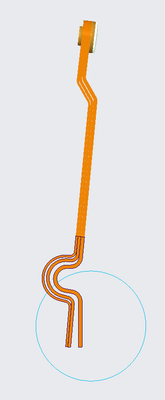

I have a set of leaf springs that are tied together at both ends via rivets. When the springs are in their free states, they don't lie on top of each other. Thus, the assy only contacts the mating points when under strain.
I presume I need to mate one end and then use a bonded interface that will pull together the needed surfaces during the simulation. I understand that this is only possible using FEM mode.
I am on Creo 4, M150
I don't have a standalone solver.
What are my options?

This is an electrical contact arrangement. the right-most member is made of an alloy that resists stress relaxation, and it is relied upon to create the normal force at the contact face. The other two sister pieces are high conductivity copper. They will not apply any of the force, and so are formed to be in an un-stressed state when the contacts are in their "MADE" position. Thus, the pic shows all parts in free state before final assy. Thus, the stress analysis must force the (3) together in the area circled, then other constraints applied for the analysis.

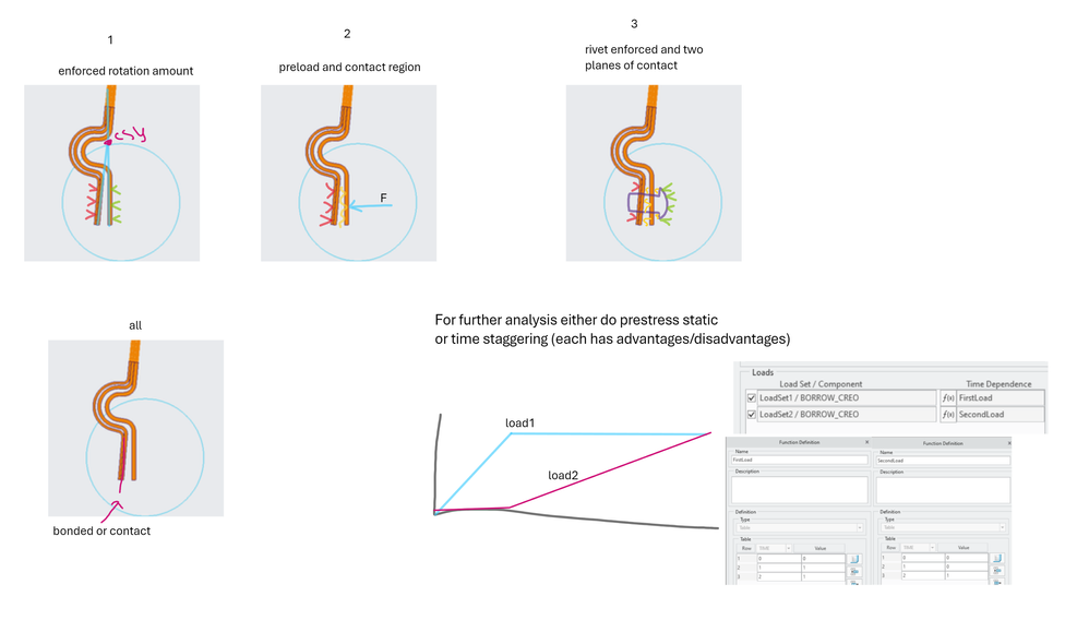

Seems doable. I have a few ideas. The time staggering can also be put on enforced displacements. (not just forces)
I am re-opening, because, although I conceptually see what you are saying, I wonder if you can point me to a Youtube or other demonstration of this approach in action. I've never done much with assemblies. How does one "enforce a rivet"? How does one run the time dependence? Is that something I need a newer version than Creo 4?

I would calculate in 2D
a example att.
