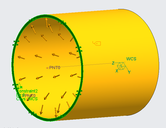

I would like to simulate in Creo 4 the mechanical stress and deformation of a thin-walled tube under an internal gas pressure.
I am having problems finding the best constraints for the results that I want.
Ideally, I would like to constrain the tube around its central axis. So that the resulting deformation of the tube wall is axi-symmetric around the tube central axis.
But I can't find a way to constrain the tube around its axis.

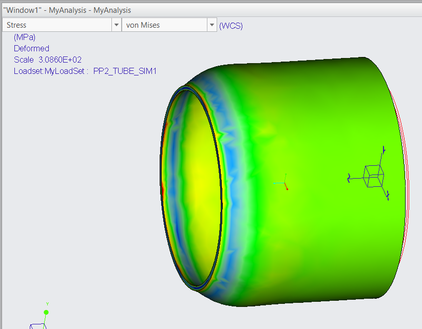

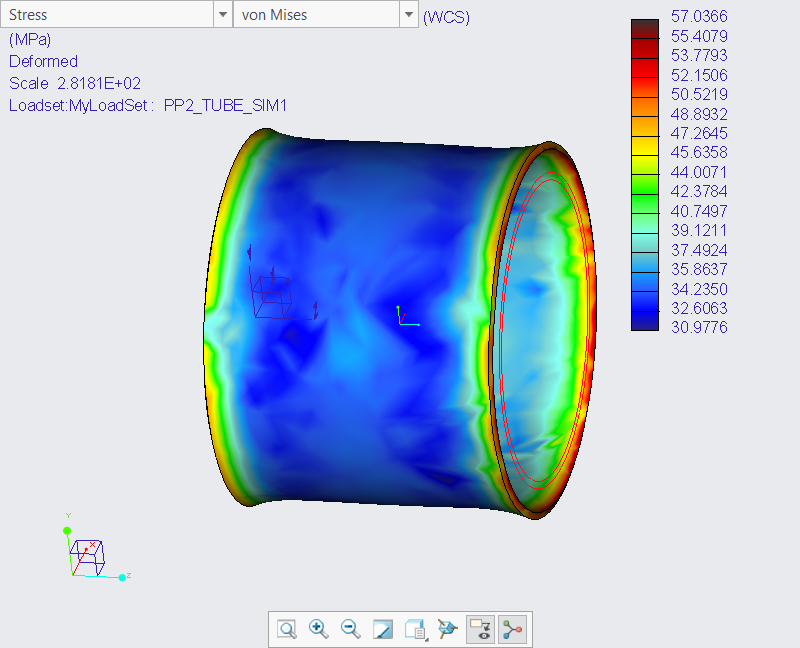

The only contraints that lead to some results (although not the ones I want) is to use the (flat) starting surface of the tube.
If I use the 'Planar' constraint (or Z = fixed, X and Y free) I get stresses that seem acceptable, but the deformation is wrong and not axi-symmetrical.
If I fix the surface in X,Y and Z, I get a result, but as expected, the deformation is 'weird'.
If I constrain as a 'Pin', that does not work.

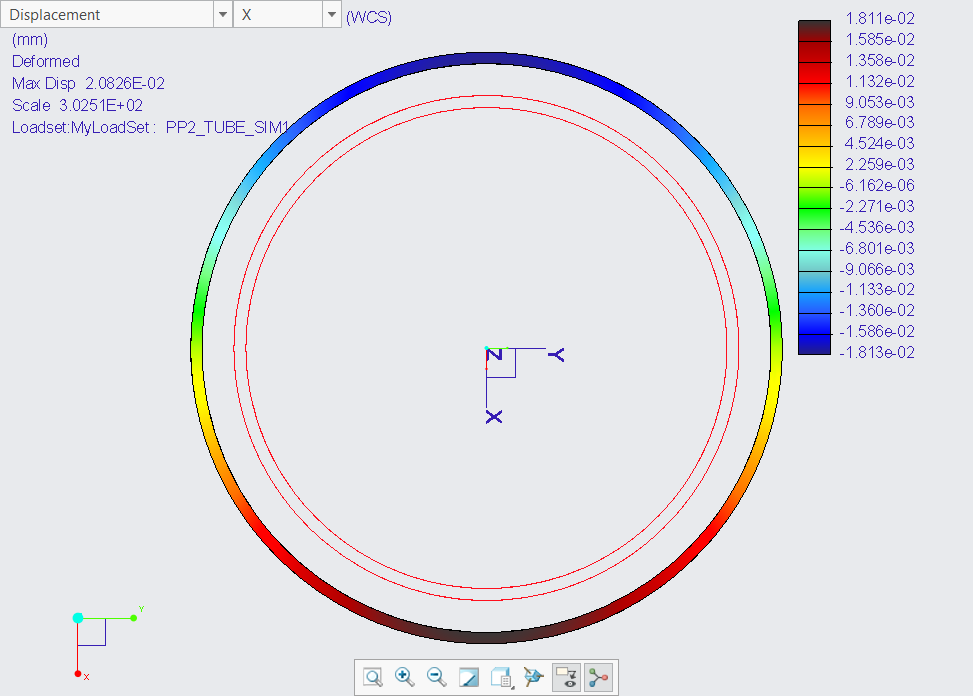

Best answer by EddyVE
I think I have found a way to achieve what I had in mind.
First, create a new coordinate system, but make sure it is a cylindrical one. Put the CS on the tube axis, with 2 datumplanes as references.
 Define displacement for the end surface of the tube, where you use the cylindrical CS as reference. Fix Z and Theta. Keep R free.
This solves into a nice axi-symmetric deformation, and the VM stress matches my manual calculation.
To check the diameter deformation, I have to use X or Y deformation. Using 'Magnitude' takes the shortening of the tube into account, which I don't need.

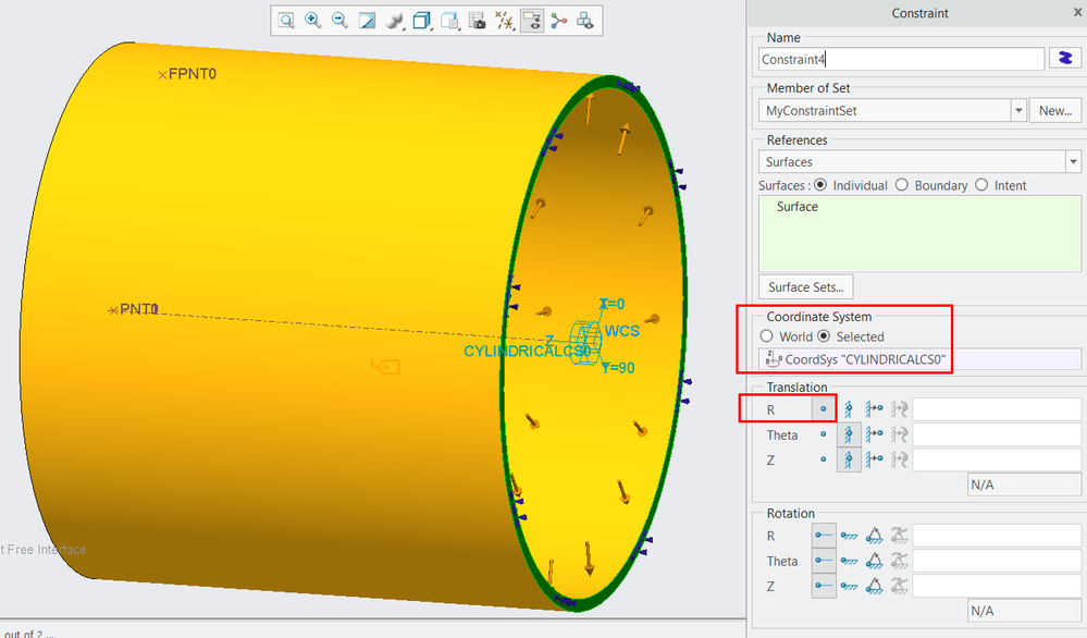

EddyVE12-AmethystAuthorAnswer
February 16, 2023

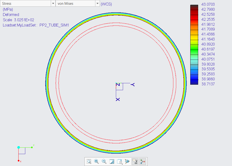

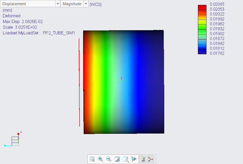

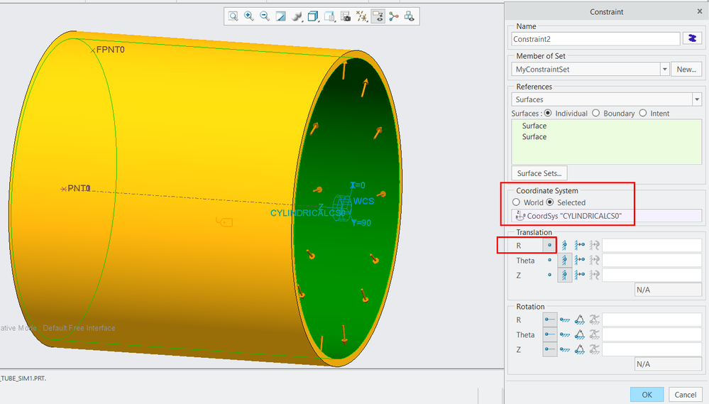

February 16, 2023
I also tried by using the inner tube wall surface as displacement reference. Same cylindrical CS as reference, also R free, Z and Theta fixed.
The result was not as accurate as the above because the fixed Z prevented the shortening of the tube. Showing like this:
Fixing Z prevents shortening of tube.Fixing Z prevents shortening of tube.creo_tubeOK6.png

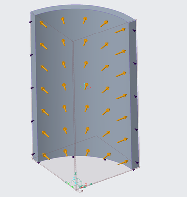

skunks
February 17, 2023

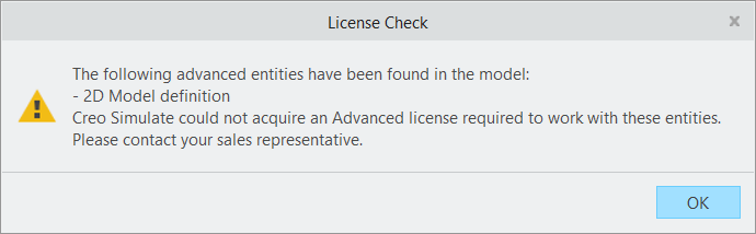

February 17, 2023
Thank you for providing the example. Unfortunately, I do not have the required Simulate license.
skunks
February 17, 2023
3D example
