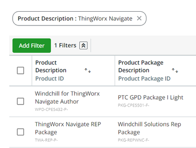

@joe_morton , @TomU There is one product in particular that is used across Windchill and ThingWorx bundles. It is ThingWorx Navigate. Since you are intending for a Windchill Instance, you need to ensure you are selecting the Windchill version which is noted in the Product Description and can be identified by the Product ID starting with 'W' instead of 'T' - if you select the ThingWorx Product ID, the system will prompt for the relevant device ID.
Here's a side by side as an example:
