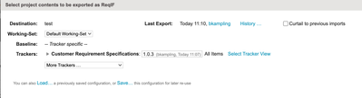

You cannot restore from a baseline, but you can export the project as a ReqIF archive from a specific baseline and then reimport at HEAD. Could you provide more details about your situation so I can offer more targeted advice?
