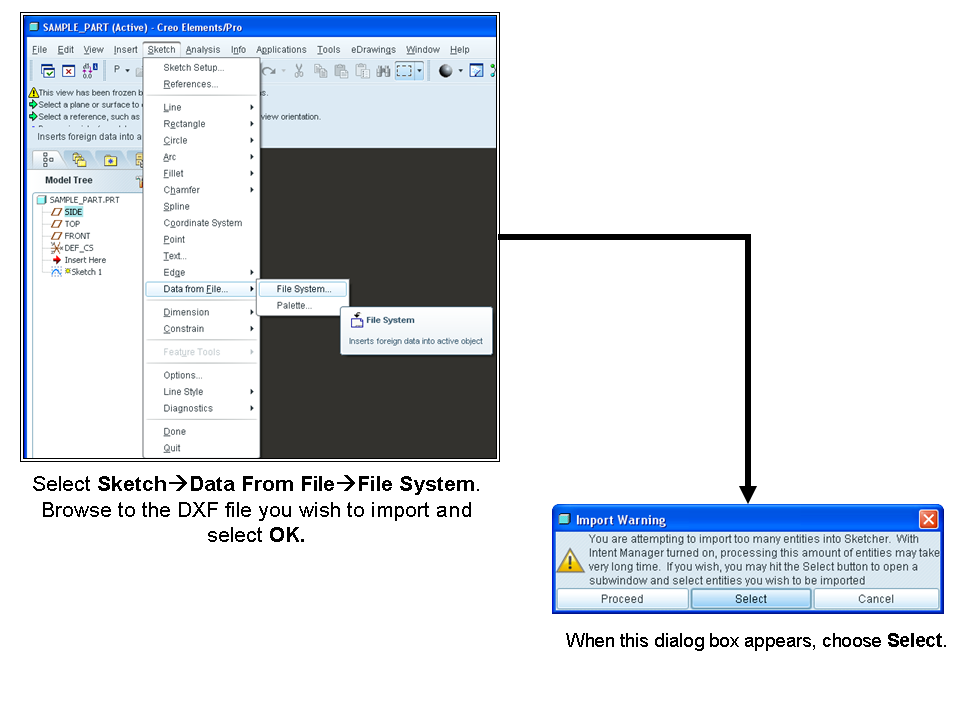

1. create new part in pro-e
2. go to sketch
3. insert the autocad file(insert data from file)
4.delete extra views
5.create a extrude feature using the section with a standard length
6.make a family table with variable length
7. use your required part as per length
please ask if you face problem in any step

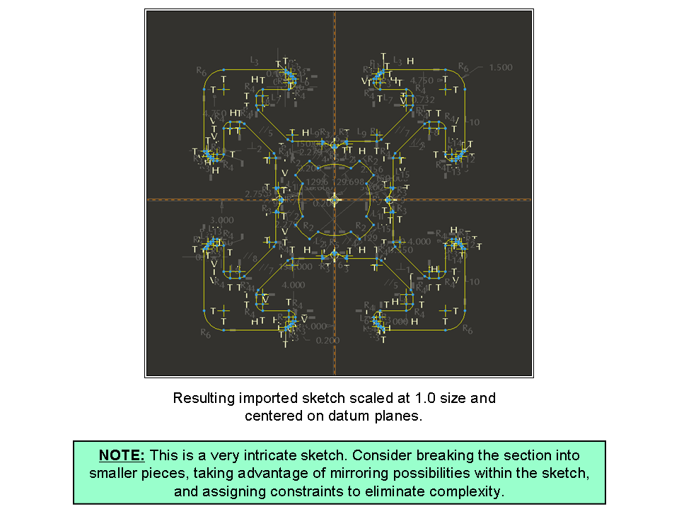

Ahhh... Mr. Mahanta has it right! Should've thought of that... using the DXF import will give you edges to extrude.
Once you have the sketch for this extrusion, save it to your Sketcher Palette so you and your co-workers can retrieve it quickly and reuse it for any length!

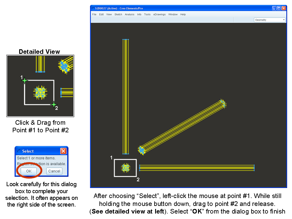

Thanks. I made some progress on your instructions. I am now at your step 4. In other words, I got to the point where I see four views, 3 of which are extraneous to the tasks I need to accomplished. Unfortunately, there are no delete options. I can select the extra views but, afterwards, I can delete them. This option is not selectable.
Hi
In the Second images If you can see the option Proceed ,Select or cancel
1. you can proceed and then in the sketch delete the extra views
2. or only select the required views(sectional view)
(Are you still facing any problem)

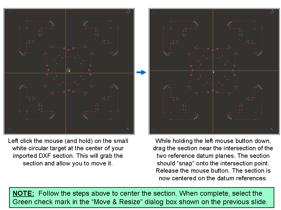

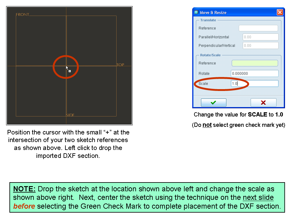

Hi Byron...
I was actually able to use the technique I suggested AND Mr. Mahanta's suggestion to create the same geometry. I re-read your post and I thought perhaps the problem was that you're using Creo Parametric 1.0 and we're trying to explain the process in Creo Elements/Pro (Wildfire 5).
So... I went back and checked the procedure in Creo Parametric 1.0 but it's actually the same. To elaborate on step 4, see below... click on any of the images for a larger size view that's easier to read...
I hope that clears up the remainder of the steps. If this is still unclear, please let us know.
Thanks!
-Brian
