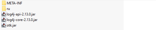

Please tell me how to add dependencies (other jar files) to the project jar file.
For example, I want to use logging during development, but I can not start the application, since Creo throws an error that the class will not find.
I used the gradle build tool.
I pointed out the classpath in MANIFEST, added jar files inside my jar, but it still doesn't work.

My jar:
My MANIFEST:

you can add information about dependencies in the registry file called creotk.dat or protk.dat to field java_app_classpath.
For more info search CLASSPATH Variables and Registry File in documentation.

Thanks for the answer!
