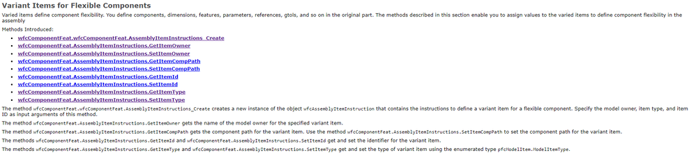

See chapter in User's Guide "Variant Items for Flexible Components"
