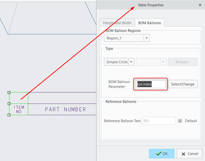

I want to set up a drawing template (or would also be happy with a format) where the BOM Balloons pick the numbering for assembly items not from a rpt.index, but a Find Number parameter. In an actual drawing I know how to set this (change rpt.index to asm.mbr.cparam.FINDNUMBER)...
...but I'd like to have this set already from start when creating the drawings.

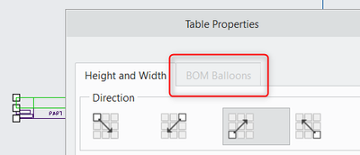

In a drawing template (.drw) the BOM Balloons tab of Table Properties is greyed out, as there's no model to "balloon".
This is my catch 22. I'd like users not having to manually change this in the BOM table for every drawing they create.
Does anyone have an idea to achieve this for a template or format?

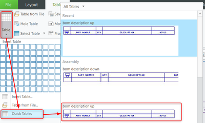

I am able to reproduce the problem with quick table named bom description up inside empty drawing (i.e. template drawing).
The problem can be also reproduced with manually created table containing 2 lines. I created the same table as bom description up.
The problem can be reproduced when the drawing does not have a model assigned.
Workaround:
  • create new drawing
  • assign a model to the drawing
  • place quick table named bom description up into the drawing
  • modify table properties as needed
  • save table into .tbl file
  • open drawing template
  • import .tbl file into drawing template
  • save drawing template
  • verify whether drawing template works well
Martin Hanák

You need to automate the change of a particular report parameter in the Table Properties. This Table Properties requires a model to balloon hence the change has to be dynamic and cannot be perform by a template that's static.
It is also confirmed by this article that no option exists to set that parameter by default : https://www.ptc.com/en/support/article/cs197755
Why not create mapkey like suggested by the article resolution?
and let your users call that mapkey.
That mapkey will create the drawing, will call on the template that in turn will take the model in session, willcreate the table and once the table is in the drawing will apply the change?

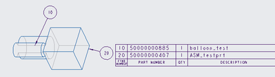

in Creo 7.0.5.0 everything works well. See video FINDNUMBER.mp4 and investigate attached files.
Martin Hanák

There are almost small tears in the corner of my eyes right now. 😃
This was the solution I was looking for, your workaround did the trick. Thank you, @MartinHanak!
