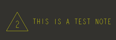

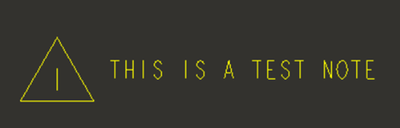

I was wondering if we can design a custom symbol in CREO where instead of typing variable text in dialog box, we can directly type the variable text in Annotation note itself:
For example:
On typing "&sym(TRIANGLE_1) THIS IS A TEST NOTE" I should get following result :
And on typing "&sym(TRIANGLE_2) THIS IS A TEST NOTE" I should get following result :
AND HENCE FORTH....
I have seen similar capabilities in other design softwares, was wondering if similar approach exists in CREO.
Please let me know if this can be done, since I am working on an automation tool.

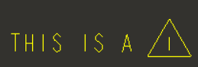

To put it in simple terms I wanted to know if I can replace some text in Annotation note with some symbol having variable text.
For Ex: If there is an annotation note saying  "THIS IS A TESTSYMBOL"
I want to replace the text TESTSYMBOL with a symbol
Doing this manually would involve me replacing the text "TESTSYMBOL" with &sym($symbolName$) and then entering the variable text "1" in dialog.
I want to achieve this through code.
PS: I already know how to place a symbol in a location by cood or letting the user to select point. My issue is how to replace some text in annotation note with symbol having variable text.

Thanks a lot for your response.
You were right, vbapi does not have the necessary api call to do this.
As a substitute what I did was
1) Evaluate the exact location where the symbol needs to be added, and add it
2) Relate the flag note symbol to the note (so that symbol moves along with notes)
Having the symbol syntax is the best way to go. But this is a substitute for those who are using vbapi.
