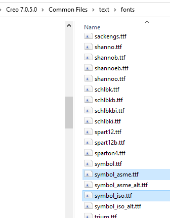

simply search Creo installation directory tree for files with ttf extension. If the filename contains ansi string then you hit the target. More details tomorrow.
Martin Hanák
below you can see the location of ttf fonts.
Note:
Creo proprietary fonts defined in src files and then compiled into fnt files are very different from ttf fonts:
Martin Hanák
Note:
detail option SYMBOL_FONT value must be set to the same value in parts, assemblies, drawings.
Martin Hanák
