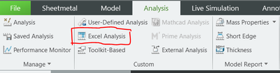

Pls help me in any automation of a 3D model using Excel analysis option while working in workspace (online) with linking to a excel sheet located in local drive.

Requires purchase of BMX option
By studying VBA Excel, even designers can develop programs.
We will send you a brief(?) sample code.  blog site : https://tool-2020.tistory.com/697
It's in Korean
You must install the CREO VBA API.
License is free
Site related to CREO VBA API installation :  https://community.ptc.com/t5/Creo-Parametric-Ideas/VBA-Macros-API-for-Creo/idi-p/546481
