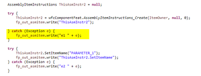

hi  ysinitsyn,
could you look at it?? There is still  issue 😞

I've tried earlier - no success.
What is more, I used log to get an error message
Result:

Try to create AssemblyItemInstructions_Create with any ModelItemType.
Then set a name AssemblyItemInstructions.SetItemName.
Maybe, the item type will be ignored in case of a parameters (as described in the documentation).
For me, looks like a bug in Java API. ModelItemType class don't have _ModelItemType_null. Only null

But in AssemblyItemInstructions_Create I see a check that the arguments must not be equal null.
public static AssemblyItemInstructions AssemblyItemInstructions_Create(Model paramModel, ModelItemType paramModelItemType, int paramInt) throws jxthrowable {
    if (paramModel == null) {
      throw XNullInNonOptArg.Create("ItemOwner");
    if (paramModelItemType == null) {
      throw XNullInNonOptArg.Create("ItemType");
    CIPRemoteComm cIPRemoteComm = CIPRemoteApp.getComm();
    CIPTransport cIPTransport = CIPRemoteApp.getTransport();
    long l = cIPTransport.obtainObjectPtr(paramModel);
    cIPRemoteComm.sendCall();
    cIPTransport.sendInt(6021);
    cIPTransport.sendObjectPtr(l);
    cIPTransport.sendInt(ModelItemType.getValue(paramModelItemType));
    cIPTransport.sendInt(paramInt);
    cIPRemoteComm.processMessages();
    return (AssemblyItemInstructions)cIPTransport.recvObject(CIPRemoteApp.getObjectMaker());
hi @YaroslavSin ,
just in case you are still interested in my case, PTC has opened SPR.
Krzysztof
