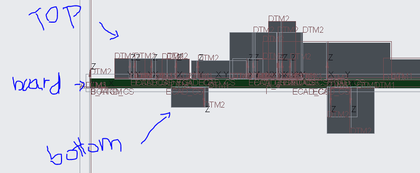

Well, I want to know how to differ the top components from the bottom components placed in a card board after getting all of them with ProSolidDispCompVisit .Capture.PNG
Hello.
I think, you can analyze Z-axis direction. Compare Z-axis of each component model and card board Z-axis.
Take a look
https://community.ptc.com/t5/Customization/Get-global-coordinates-of-entry-port-coordinate-system-with/m-p/756058#M10635
Thank you! That's right!

Well, I want to get all dispayed components and differ the components placed in top side of the board from the one placed in bottom side.
MichelH
(To:JD_2779181)
If you have the ComponentPath of each component you can use Transform3D::GetZAxis to get the location.
Comment: I am working with OTK Java, but should be similar with toolkit...
