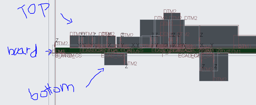

I have to get all part component from an assembly and group all those components in top or bottom group. Is there a function that allows to differ top and bottom components?
I use ProSolidDispCompVisit to visit all components. Put all in an array with ProArrayObjectAdd and loop all models. I want to separate top from bottom and create/fill group with.

Can you provide more information about what you mention by "Top components" and "Bottom components"? The order in the assembly tree? Assembled first components (placed at first half of the tree) is - top?
First of all thank you!
Well, I want to know how to differ the top components from the bottom components placed in a card board after getting all of them with ProSolidDispCompVisit .Capture.PNG

I think, you can analyze Z-axis direction. Compare Z-axis of each component model and card board Z-axis.
Take a look

Thank you anwering me.
Well, I want to get all dispayed components and differ the components placed in top side of the board from the one placed in bottom side.
