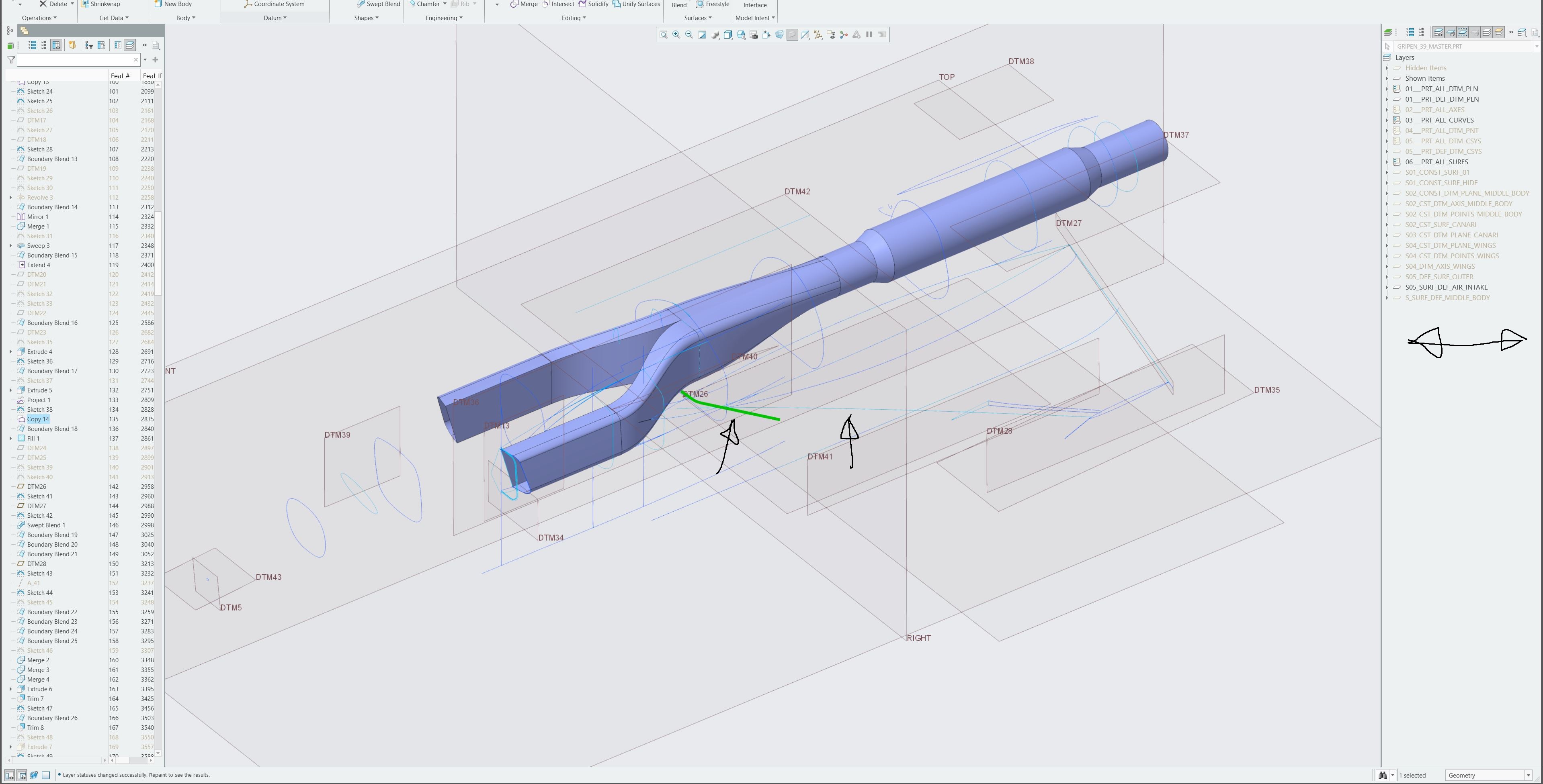

My first problem is how to setup Layer tab width on creo startup or when open new work file , ( as every time minimizes for every new part file ) ( see attached image )

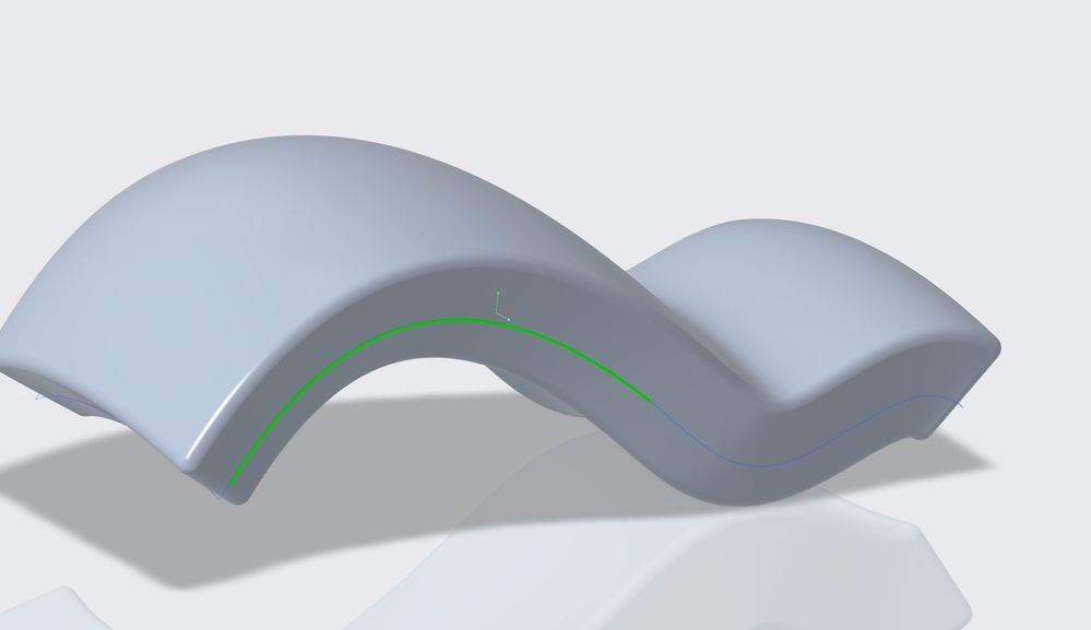

Second problem I need help with is how to setup line thickness? I would need a less thick selected line, and more thick general lines in 3D model , as this lines are so thin and barely visible on 4K monitors ( see attached )

Assuming you are using a more recent version of Creo then you need to use customization.ui files to "save and load" the model tree as you want. You can at any time save UI customizations to a file that if loaded when Creo restarts will keep the saved settings.
.ui files quick reference data: Article - CS37185 - Quick Reference and customization of the user interface in Creo Parametric
Overview of the .ui files administration: Article - CS288341 - Information about customization.ui files and their loading preference at application startup for Creo Parametric

Thank you for fast reply. I was in creo 10 , now in 11.
I have modified template files for new parts, and they have remembered tree tabs and width on left side, and that layer column is on right side of screen aka interface ( tho every time width of layer column is default , cant find a way to save custom width )
I was trying to create and load tree file, but that leads me to loading new tree file for every new part to make a custom width...
As for the edits of line thickness in interface , I was going trough suggestions but couldn't find anything regarding this specific customization.
I was hoping that there is a setting in options or somewhere where I could chose line thickness...

regarding the layer tab, even I, when evaluating the transition from Creo 9 to Creo 11, am not appreciating its behavior.
I am still looking for a way to customize its size.
In my case it seems that at each transition from one window to another, the height of the layer tab is always reset to half the height of the left column.
In practice the height of the left column is exactly divided in half between the layer tab and the model tree.
Personally I do not like this behavior, in Creo 9.0.8.0 I do not have this problem.
Personally, this anomaly is added to the list of anomalies for which I have not yet switched to Creo 11.
Regarding the line thickness of the highlights, if you haven't seen it, I point you to my old topic:
https://community.ptc.com/t5/Creo-Parametric-Ideas/Add-a-config-option-to-come-back-to-the-highlighting-with-thin/idi-p/751985
and my old proposal as an idea for implementing the program, which however has recently been archived.
Maybe you can propose a new idea again to be able to manage the thickness of the highlighted lines, maybe it will be more successful.
If you think it's appropriate, mention my old idea.

From what I have understood , you are using both model tree column and layer column on the left side of interface , that is defaulting to half, horisontaly?
In my case I am having layer column on right side of interface and with every new file it is defaulting the width of layer column that is the thinner that I have made it.
Only thing I have managed to achieve in config file that I load in every new project or file that layer tree exists at all.
As for the line thickness both for lines that are not selected or selected and have too big thickness , no luck at all. Still the same issue.

here it is my problem again in case someone sees it .
On 4K monitors, Selected line thickness vs not selected line from style or sketch.
Selected line is too thick, and style/sketch line is barely visible.
It would be amazing if there is a chance to change the thickness of this lines manually ( to choose how much thinner is selected line and what line thickness is for sketched or style line!!!
This is especially big problem when the model is complex with a lot of lines...
Thank you.

Still no solution to layer tab fixed width as I would like . And to stay like that in project , or to be a default setup for all future projects or templates. ...
