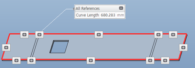

How to get outline curve length in sheet metal ? (Plz share idea)
We try to get outline curve length. (outline curve mean highlight in picture)
Our solution is simple.
1. create section
2. get section curve
3. get curve length

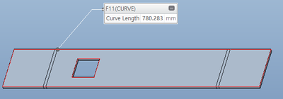

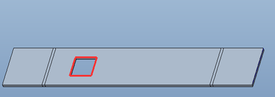

But, section curve have all curve.
We do not need inside curve (highlight in picture)
Please give me an idea if there is a better way.
Thanks, Wram Regards.
SeonHo CHA.

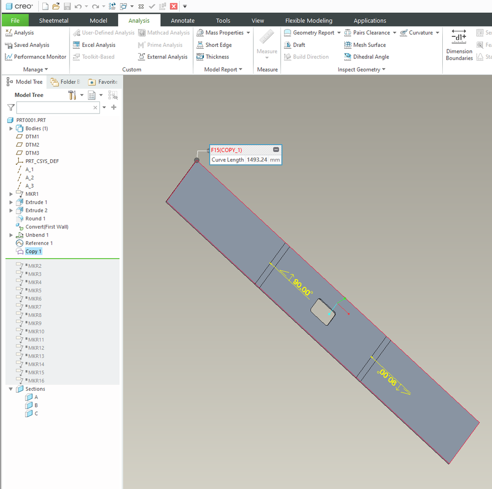

One option is to create an intent chain of the unbent model perimeter. Then create a curve copy of the intent chain. You can then use an analysis feature to measure the length of the outline curve.
