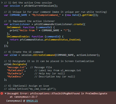

Hello, i've been tryign ot designate created command in PTC Creo JS API and didn't succed at all.
Creo API can't find message file. I've been also trying to create absolute path to message file but it didn't work too.
Here is my code example:
// 1) Get the active Creo session
var session = pfcGetCurrentSession();
// 2) Unique id for your command (make it unique per run while testing)
var COMMAND_NAME = "MyJsSampleCommand_" + (new Date().getTime());
// 3) Implement the action listener
var actionListener = pfcUICommandActionListener.create({
  OnCommand: function (commandId) {
    print("Hello from " + COMMAND_NAME + "!");
  OnCommandEnable: function (commandId) {
    return pfcCommandStatus.pfcCommandStatus_Enabled;
// 4) Create the UI command
var uiCmd = session.UICreateCommand(COMMAND_NAME, actionListener);

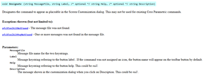

// 5) Designate it so it can be placed in Screen Customization
uiCmd.Designate(
  "message.txt",  // Message file
  "MyCmdLabel",      // Label key from ui_message.txt
  "MyCmdHelp",       // Help key (or null)
  "MyCmdDesc"        // Description key (or null)
// 6) (Optional) Assign an icon
// uiCmd.SetIcon("my_cmd_icon.gif");
Screenshot from support.ptc.com no directory described:

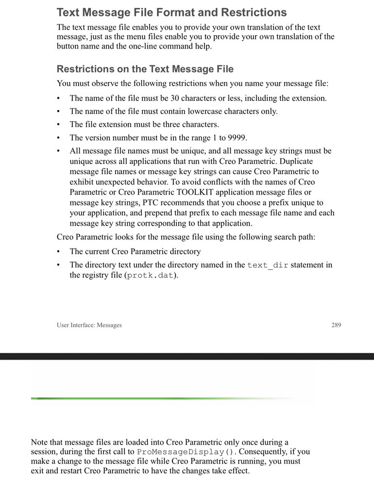

screenshot from pdf no directory described:
There is also no format and description about how does this file has to look like.
Here is how it looks like when i run it via DevTools
Message file has to be placen not into %PRO_DIRECTORY%\text but  %PRO_DIRECTORY%\text\%YOUR_LANGUAGE%
In my case it was usascii
Whole path than looked like C:\Applic\Creo_11.0.3.0\Common_Files\text\usascii
also for icon not text file but text\resource
Whole path than looked like C:\Applic\Creo_11.0.3.0\Common_Files\text\resource

The doc is telling about a message file, and your code is using two of them. In toolkit you specify the text folder in the registry file protk.dat or creotk.dat. You need to check the PTC documentation for one example. I guess in JS it is similar, and you need to map your string token in the given message file.
RPN
(To:ilyachaban)
Here some note from the tk manual. Note: Using message.txt may dangerous 😉😵💫
Hello @ilyachaban,
It looks like you have some responses from a community member. If any of these replies helped you solve your question please mark the appropriate reply as the Accepted Solution.
Vivek N.
Community Moderation Team.
Web.Link User’s Guide. Accessing the Creo Parametric Interface:
Remember that Web.Link applications, as unregistered web pages, do not
currently support setting of the Creo Parametric text directory. All the resource
files for messages must be located under $PRO_DIRECTORY/text folder.
You can force Creo Parametric to load a message file by registering a Creo
TOOLKIT or J-Link application via the web page, and calling a function or
method that requires the message file. Once the file has been loaded by Creo
Parametric, Web.Link applications may use any of its keystrings for displaying
messages in the message window.
