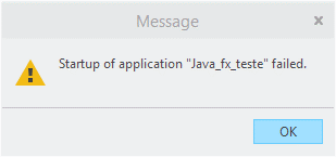

I've made a few sync app with java. Now I would like to create a few app with java fx. But didn't foud a way to start the application. Every time I run CREO, i've the message error:
Any help of how to assemble the code, creotk.dat, config.pro?
Thanks in advance
