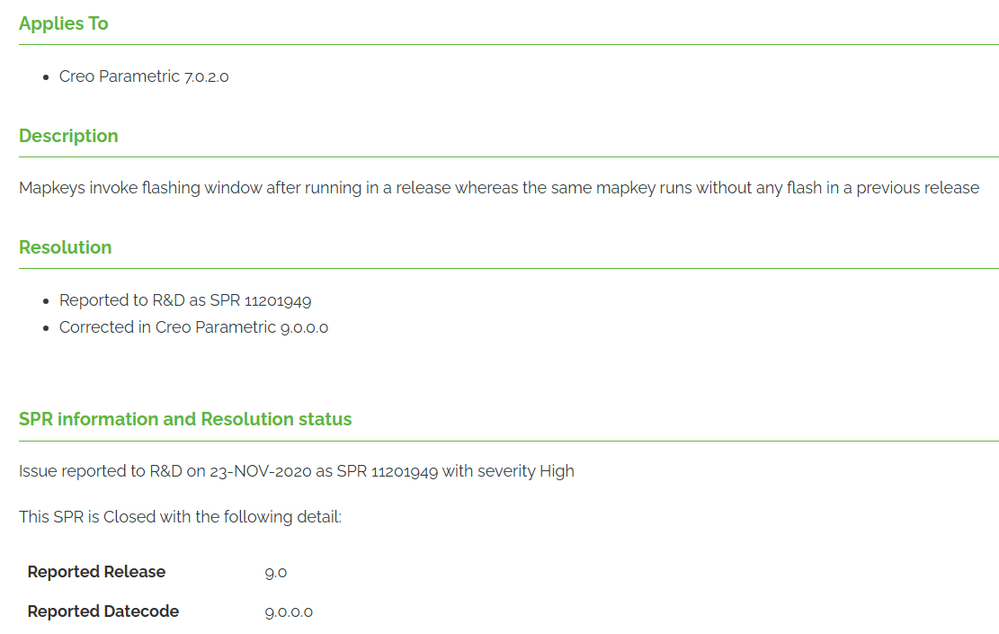

PTC has a fix planned for Creo 9
  • Reported to R&D as SPR 11201949
  • Corrected in Creo Parametric 9.0.0.0

I'm running Creo 10, and I still see the flashing windows - When you say "corrected in Creo 9", is there a config option, or is it just not supposed to happen anymore?
tbraxton
(To:lockarde)
No config option. Code is supposedly updated to resolve the issue. See article below. If you find that the issue has not been fixed, open a new call with PTC and reference this article. Also post here that you have opened a new call on this issue.
https://www.ptc.com/en/support/article/CS334396

Chris3
(To:tbraxton)
Either that link is not complete or that article is something that only your account can see.
tbraxton
(To:Chris3)
Anyone with a valid PTC support account should be able to access that article. It is behind the PTC support firewall so you will need an account to log in.
