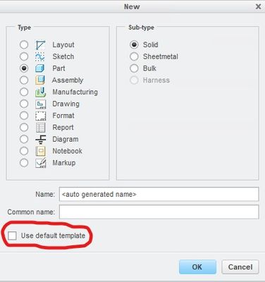

  3. Make sure to uncheck the "Use default template" box and click the OK button to continue.
  4. Uncheck_Default_LI.jpgOn the next popup, click the Browse.. button and navigate to the part you want to copy. In my case, this is 8020_1515 and it resides in our Part LIbrary.No_Default_Template_LI.jpg
