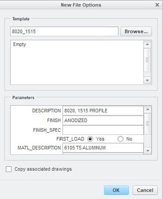

For those viewing this solution after the fact, here's the step-by-step:
  1. Create a new part by clicking the New button (Ctrl + N by default)
  2. Select the Part option and choose which ever Sub-type applies to the situation (Solid in my case).
  3. Make sure to uncheck the "Use default template" box and click the OK button to continue.
  4. Uncheck_Default_LI.jpgOn the next popup, click the Browse.. button and navigate to the part you want to copy. In my case, this is 8020_1515 and it resides in our Part LIbrary.No_Default_Template_LI.jpg
  5. Fill out the parameters as needed and click OK to create the part!
