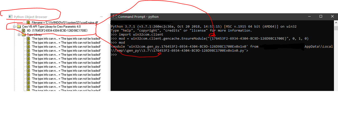

if automating with python meant using creo's COM type libraries than it should be doablepython-creo.png
python will import and generate a stab module for whatever is in Creo Type Library but the end result will be the same quite limited functionality as with VB.
