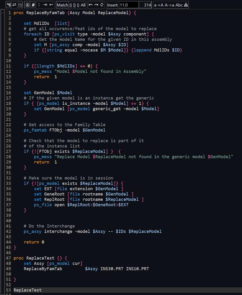

Hi all,
I am having issue with this not working. What am I missing?
I would expect it to replace PHILLIPS7_8 with SLOT7_8
It looks like it runs but nothing gets replaced
This is taken from the example code.

RPN
(To:jbryant74)
I‘m not the jlink guy, but what I see in your code (I may wrong), you create a new instance, but it is basically the generic one, so no difference.
Prepare your family table in that way, to see a difference for the replaced one. Next in your code, get the handle for the instance  to replace, instead of creating a new instance.
Here (other language) replace ins30.prt with ins10.prt
