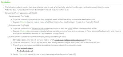

I'm reading the following article (https://www.ptc.com/en/support/article/CS420647):
Trying to unbend sheetmetal through Creo's C++ TOOLKIT provided example (without user interaction) results in memory access exceptions no matter what I do.
Looking for alternative solutions, I've found the article above.
At the end, it says I could use the following functions
  • ProCmdSmtFlatPat()
  • ProCmdSmtUnbend()
Using Creo's interactive mode, but I can't find any reference for
this mode neither for the functions listed.
Where can I find these two functions?

This 2 commands are mapkeys, as mentioned in the article.
RS_11013548
(To:RPN)
Well, that's unfortunate 😕
Apparently, we can not use mapkeys on TOOLKIT to press Ok buttons...
It wasn't able to fully unbend the sheet
RPN
(To:RS_11013548)
You are right if you do this from scratch, but the unbend is a feature, most of the time the last one. You can just suppress or resume the feature.
But there is Toolkit Code, just check the first couple of features for a planar surface White/Green and provide this as an input.
With an asynchrones Toolkit App, the Mapkey could be an option.
