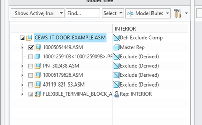

Hello I was wondering if I may be doing something incorrectly or if anyone else has ran into similar issues.
I am attempting to modify existing SimpReps in a Creo assembly. When I go through the process there is no change to the SimpRep in the Creo assembly. Any insight or help would be appreciatted, below is the code segment where activeModel is a pfcModel_ptr retrieved from the session.
The model has SimpRep "INTERIOR"  and it has a component with feature id = 450
pfcAssembly_ptr assem = pfcAssembly::cast(activeModel);
xintsequence_ptr ids = xintsequence::create();
ids->append(450);
pfcSimpRepItemPath_ptr sr_item_path = pfcSimpRepItemPath::cast(pfcSimpRepCompItemPath::Create(ids));
pfcSimpRepItem_ptr sr_item = pfcSimpRepItem::Create(sr_item_path);
pfcSimpRepAction_ptr action = pfcSimpRepAction::cast(pfcSimpRepInclude::Create());
sr_item->SetAction(action);
pfcSimpRepItems_ptr items = pfcSimpRepItems::create();
items->append(sr_item);
pfcSimpRep_ptr sr = assem->GetSimpRep("INTERIOR");
pfcSimpRepInstructions_ptr ins = sr->GetInstructions();
ins->SetDefaultAction(pfcSIMPREP_EXCLUDE);
ins->SetItems(items);
sr->SetInstructions(ins);
assem->ActivateSimpRep(sr);

4. Example of INTERIOR SimpRep definition before running application:

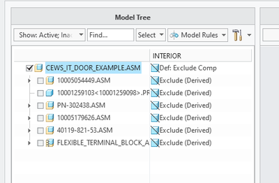

After running application with `SetItems(items)`: where items only includes 10001259103<10001259098>.PRT

I don't have a solution, but "any insight" to offer: In 2018 I used the TOOLKIT (C) SimpRep API (with Creo 2 and 4) and found an error with ProSimprepdataitemsVisit(): it falsely returned old/invisible SimpRep items (not existing in the GUI), resulting in a wrong actual model structure being extracted. Not all models were affected by this error, but I had 10 affected ones.
I have no access to the PTC call that I opened therefore (but the call ID and my documentation) - not sure about the outcome.
That said, my suggestion in your case to use the C API (instead of C++) sounds not that promising, but I would try it.

I was able to get this working using the protoolkit functions, thanks @HannesBuxbaum for the suggestion.
This is the extracted code that works to use the protoolkit functions only where needed.
ProSimprepdata* simp_rep_data;
wchar_t sr_name[PRO_NAME_SIZE];
ProStringToWstring(sr_name, (char*)"INTERIOR");
ProSimprepdataAlloc(sr_name, PRO_B_FALSE, PRO_SIMPREP_EXCLUDE, &simp_rep_data);
ids->append(450);
pfcModelItem_ptr md_item = pfcModelItem::cast(assem->GetFeatureById(450));
pfcComponentPath_ptr comp_path = pfcCreateComponentPath(assem, ids);
ProAsmcomppath* pro_comp_path = (ProAsmcomppath*)wfcGetHandleFromObject(pfcObject::cast(comp_path));
ProModelitem* pro_md_item = (ProModelitem*)wfcGetHandleFromObject(pfcObject::cast(md_item));
ProSimprepAction sr_action;
ProSimprepActionInit(PRO_SIMPREP_REVERSE, NULL, &sr_action);
ProSimprepitem sr_item;
ProSimprepdataitemInit(pro_comp_path->comp_id_table,
	pro_comp_path->table_num, pro_md_item->id, &sr_action, &sr_item);
ProSimprepdataitemAdd(simp_rep_data, &sr_item);
