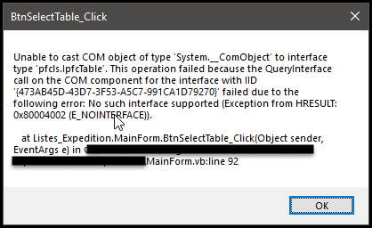

I can confirm that the selection works, if I select somethings I can get a correct COUNT of how many object I have selected.
The problem is that when I try to cast the selected object to any kind of table object to be able to work with it I get casting error:
Any idea?

The "SelectedTable.Item(i)" is returning an object of type IpfcSelection (notice the missing S at the end). This object then return an handle to the item, and can be set to the type of object you need.
