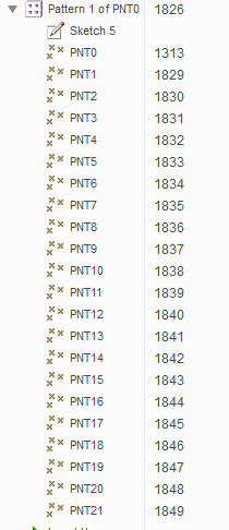

Output feature points data
Hello,.I have problem,
I want to use toolkit get points data from pattern,how can I do?
Thanks and Regards
Roger

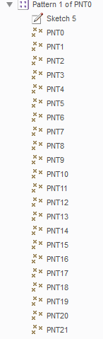

I have got the selected pattern id & handle ,how can i use your method to get points coordinate system?

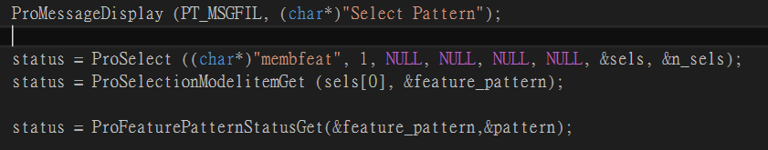

I used ProPatternMembersGet(), but it will automatically interrupt when my program runs here.
My program is below
I guess it may be necessary to set up ProPatternMemberVisit() before ProPatternMembersGet(),but i cannot use ProPatternMemberVisit().
How can I do ?

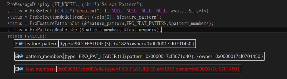

CAD_Roger
9-Granite
(To:RPN)
I used ProFeaturePatternGet() and ProPatternMembersGet() , but i can only get PATTERN_LEADER.
I wnat to know Pattern Member ,how can i do?
FV
(To:CAD_Roger)
search for a function ProUtilGeomitemDump in pt_examples UtilGeom.c, copy/paste code for PRO_POINT.
As Eike mentioned,
use ProPatternMembers get to get a ProArray of point features
use ProFeatureGeomitemGet to get ProGeomitem which is going to be a PRO_POINT
the rest is from pt_examples
do not forget to apply appropriate transformations.
HIH.
