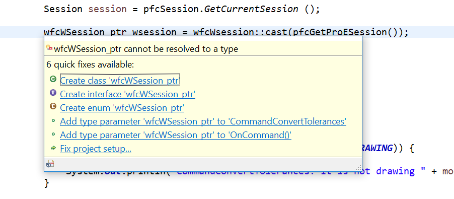

wfcWSession_ptr wsession = wfcWsession::cast(pfcGetProESession());
They use their own Smart Pointer implementation.
Br,
Eike
How i can access this Type (Pointer description)
Thank you very much!
Oh I'm sorry haven't done it in Java right now.
AFAIK it should be in the licensed OJava path. So you should need a Java OTK License for this (but I could be wrong / not sure about this ...).
