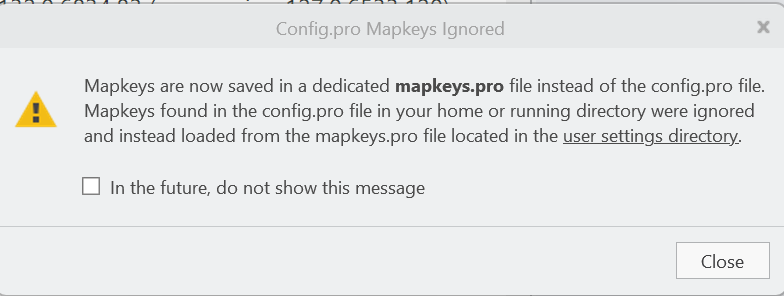

@rcrisp wrote:
Ben,
Under our existing setup this will not work. I do not want to type for an hour to explain our setup going into an excruciating long and complex list of reasons why, but basically we have 1 config file I need to use for all users and versions. This means to use with Creo 11 the config.pro has to have the mapkeys removed.
Creo Parametric 11.0 will "unhappily/happily" load a config.pro that contains mapkeys. The first time launching you will get this:
The second and subsequent times launching you will get this:
So you can select the "In the future do not show this message". That way you can still leave your mapkeys in the config.pro for your pre-Creo Parametric 11.0 setups.
BenLoosli
(To:rcrisp)
Creo 11 config.pro does not need the mapkeys removed, you just get a pop-up saying they have been copied.
If the trail files work for you, then that is okay for your environment.
rcrisp
(To:BenLoosli)
Ben,
Ok, I have not installed it yet. From what I read I thought they had to be removed.
Thank you
