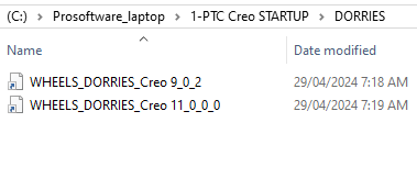

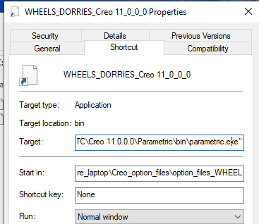

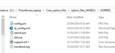

As we use Creo to manage a production plant with forging equipment , product design and CNC machines , we have found the best way to manage our operation is to have Program start shortcut that point to Creo, but with the option to start in a specific folder based on the session we are starting, not the user.
We have for each type of operation , a separate start shortcut, see below.
in this short cut, we point to a folder that stores our search.pro & config.pro files for the type of session we are about to open.
This works fine for us, as we found trying to had one search pro & config pro files wasn't a good idea, as it was trying to load everything into memory, so this arrangement allowed us to have session based setup for the task we are doing.
This include Mapkey that was setup based on the sessions needs, like setting the working directory and other folder locations for the tasks we are about to do.
All we need is to have an option in the config.pro to set where the Mapykey. Pro file is stored, like everything else, this will give us the flexibility to manage the mapkey based on the session started, and not who the user is.

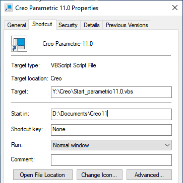

I solved this by using a batch file.
In my pro_stds directory (on a network drive), I have 2 files for starting Creo11.
"Start_Parametric11.vbs"
set oShell = CreateObject("Wscript.Shell")
set oEnv = oShell.Environment("PROCESS")
oEnv("SEE_MASK_NOZONECHECKS") = 1
oShell.Run """Y:\Creo\ptc_startup_creo11.0_x64.cmd""",0,True
oEnv.Remove("SEE_MASK_NOZONECHECKS")
 "ptc_startup_creo11.0_x64.cmd" has a couple of copy commands and then calls parametric.exe
copy /Y "<<PATH TO config.pro>>" "d:\Documents\Creo11\config.pro"
copy /Y "<<PATH TO mapkeys.pro>>" "c:\Users\Username\AppData\Roaming\PTC\ProENGINEER\Wildfire\.wf\.Settings\mapkeys.pro"
"C:\Program Files\PTC\Creo 11.0.0.0\Parametric\bin\parametric.exe"
The <<path to config.pro>> and <<path to mapkeys.pro>> reference my pro_stds/config directory on network drive.
Any number of copy commands can be executed here.  If you have multiple tasks requiring different configs, duplicate these steps for each task and change the copy commands accordingly.
Now, just point your shortcut to the VBS file and set your loadpoint as the Start In directory. Change the icon using the Parametric.exe as the icon source.
