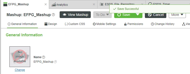

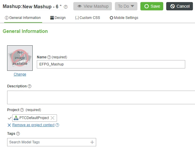

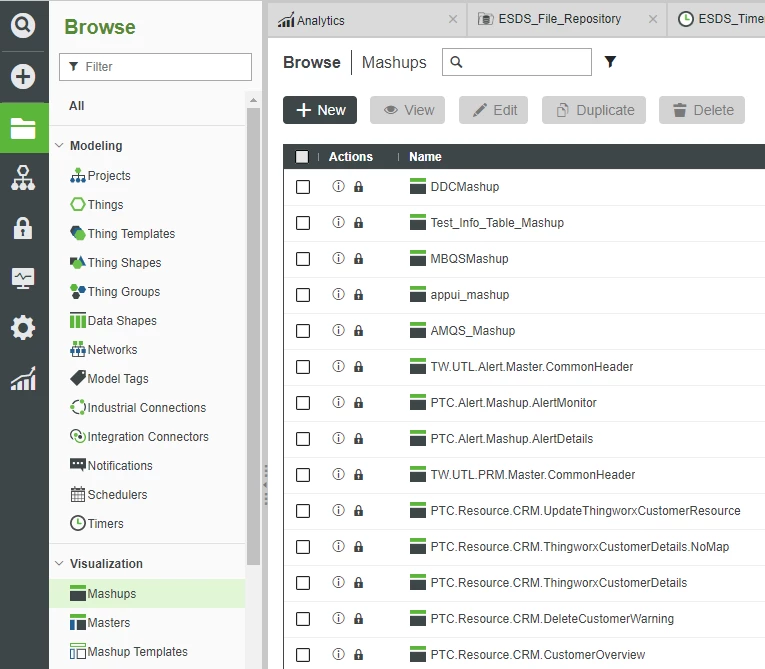

   1. In ThingWorx Foundation Composer, click Browse > Visualization > Mashups.

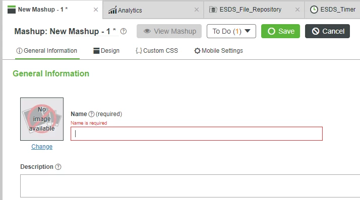

 2. Click + New.
   3. Leave the defaults and click OK.
   4. In the Name field, type EFPG_Mashup.
   5. If Project is not already set, search for and select PTCDefaultProject.
   6. At the top, click Save.

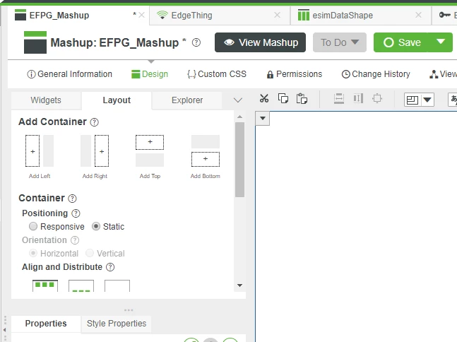

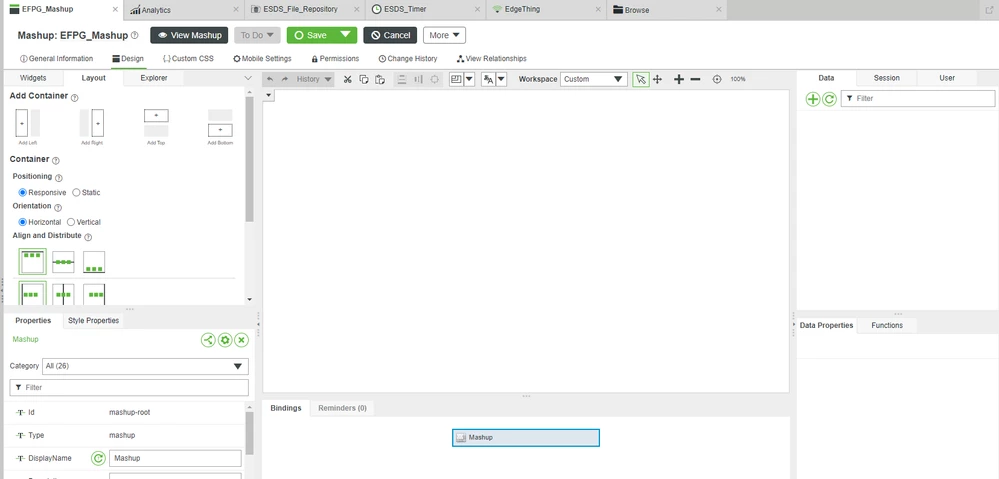

   7. At the top, click Design.
  • You are now in the Mashup Builder interface, where you can drag-and-drop graphical elements (Widgets) to create your GUI.

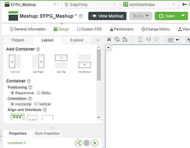

   8. At the top-left, click the Layout tab.
   9. Change Positioning to Static.
  • This removes any auto-positioning or dynamic-sizing from our Mashup, so that we can place and size Widgets manually.
   10. At the top, click Save again.

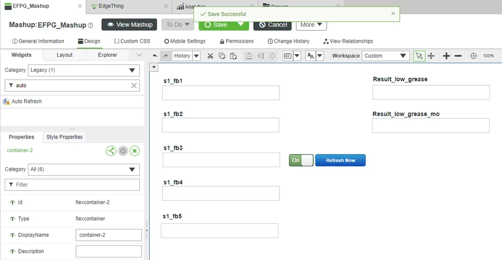

We now want to add several Widgets to our Mashup by dragging-and-dropping them into the central Canvas area.

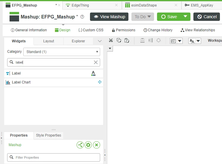

  1. Return to the Widgets tab in the top-left.
      2. In the Filter Widgets field, type label.

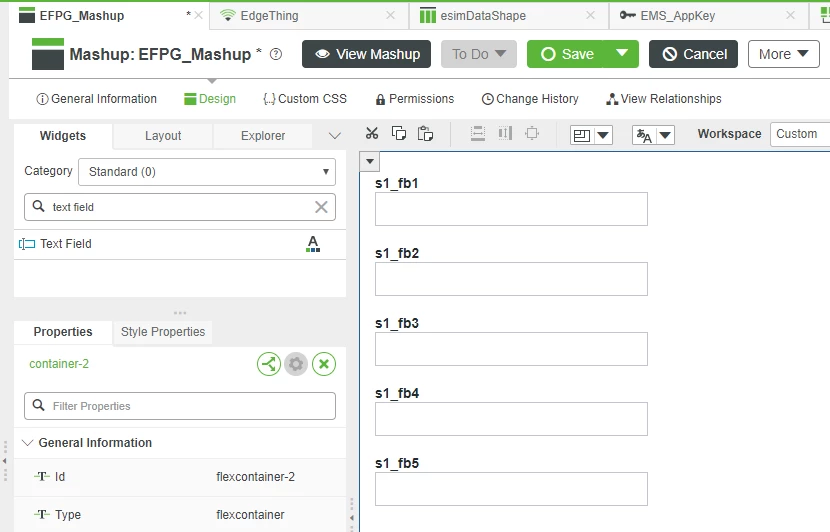

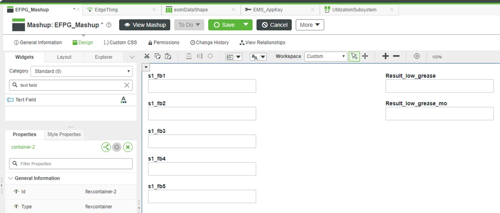

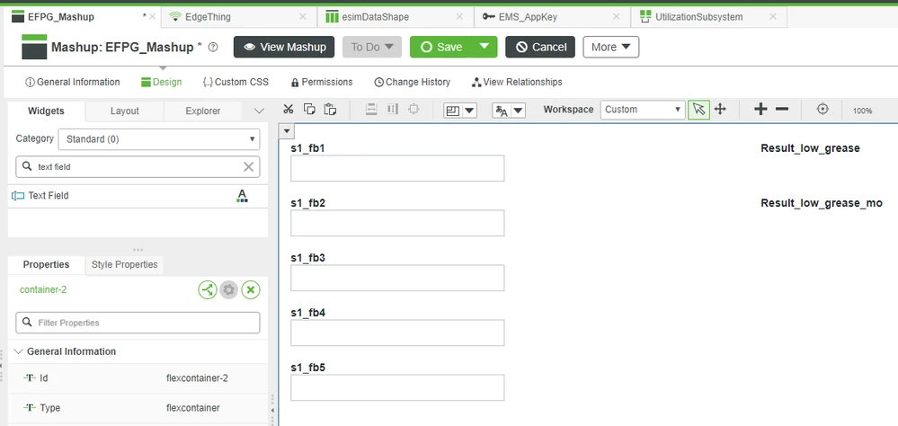

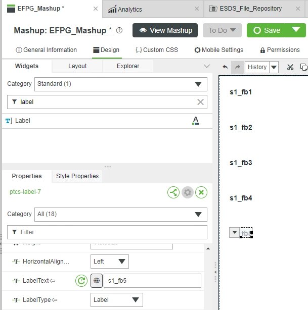

   3. Drag-and-drop five (5) Label Widgets onto the central Canvas area.
   4. Select the Label Widgets, go to the Properties in the bottom-left, and change the Label's LabelText to s1_fb1 through s1_fb5.
    5. Filter Widgets for text field, and then drag-and-drop five (5) Text Field Widgets onto the central Canvas area.

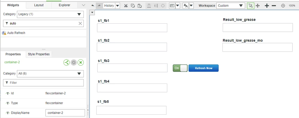

   6. Drag-and-drop two (2) more Label Widgets onto the central Canvas area.
   7. Change their LabelText Properties to Result_low_grease and Result_low_grease_mo.
   8. Drag-and-drop two (2) more Text Field Widgets onto the central Canvas area.
   9. In the top-left Widget's tab, change Category to Legacy.
   10. Drag-and-drop an Auto Refresh Widget onto the Canvas.
   11. At the top, click Save.

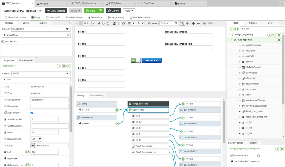

Step 4: Add Data
Now that we have a rough set of Widgets in place to display Data in our Mashup, we need to bring in backend Data from Composer.

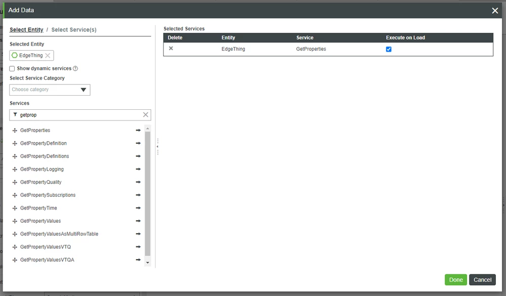

   1. In the top-right, ensure the Data tab is active.
   2. Click the green + button.

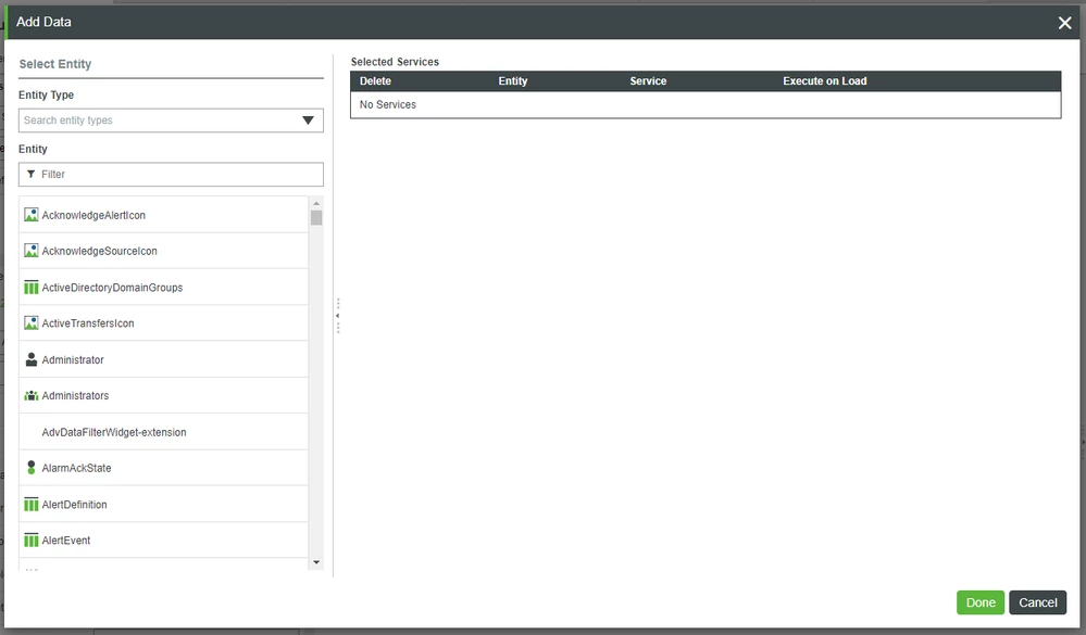

   3. In the Entity Filter field, search for and select EdgeThing.
   4. In the Services Filter field, type getprop.
   5. Click the right-arrow beside GetProperties.
   6. On the right, check Execute on Load.
   7. In the bottom-right, click Done.

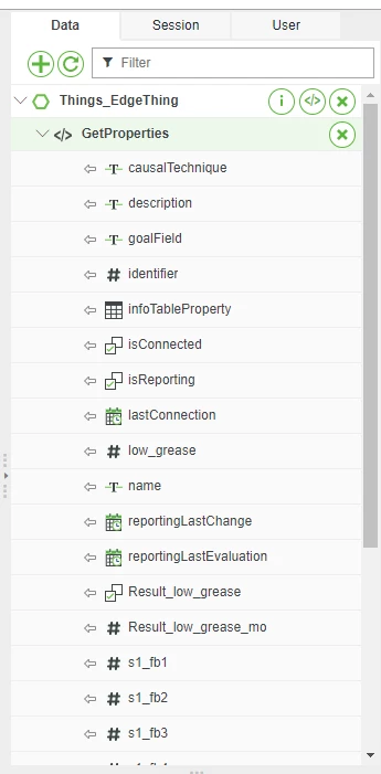

   8. On the right, expand GetProperties.
   9. At the top, click Save.

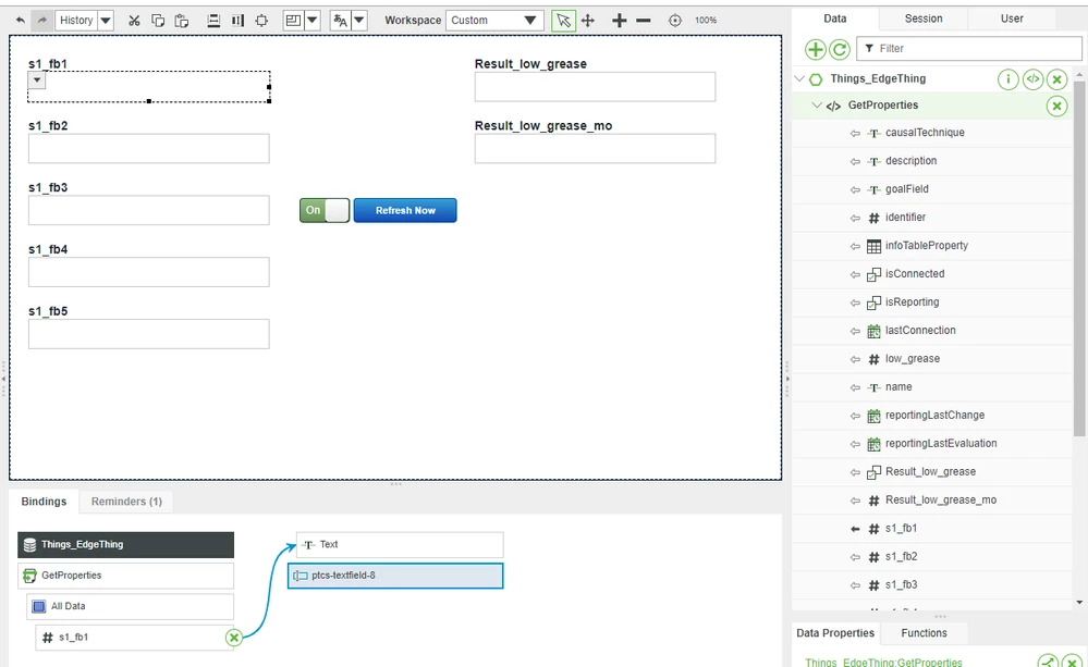

Step 5: Bind Data
Now that backend Data is accessible inside Mashup Builder, we need to bind it to the various Widgets.

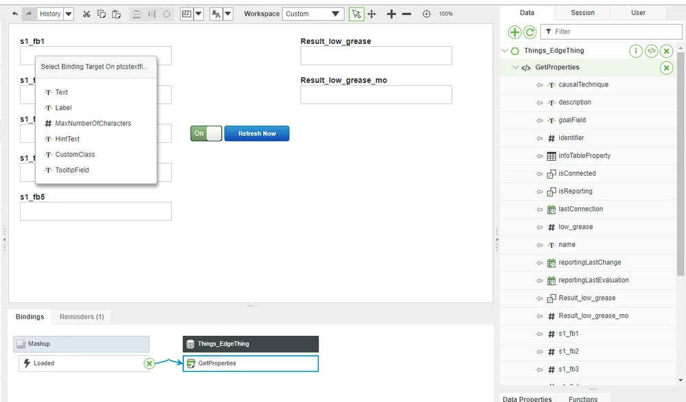

  1. Drag-and-drop Data > Things_EdgeThing > GetProperties > s1_fb1 to the top-left Text Field under the s1_fb1 Label Widget.
      2. On the Select Binding Target pop-up, click Text.
    3. Repeat for s1_fb2 through s1_fb5 on the 2nd-5th Text Field Widgets.
    4. Drag-and-drop Data > Things_EdgeThing > GetProperties > Result_low_grease to the top-right Text Field under the Result_low_grease Label Widget, and select Text on the Binding pop-up.
    5. Repeat for Result_low_grease_mo on the Text Field just below.

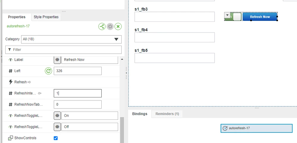

    6. Click the Auto Refresh Widget to select it.
    7. In the bottom-left Properties, set RefreshInterval to 1.
    8. With the Auto Refresh Widget still selected, click the top-left corner to reveal a drop-down.IoTProductMgmt_3-1667229055419.png
    9. Drag-and-drop the Refresh Event onto Things_EdgeThing > GetProperties.
    10. On the right, click the GetProperties Mashup Data Service to reveal all of its interactions in the bottom-center Connections window.

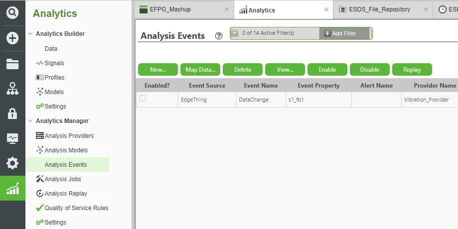

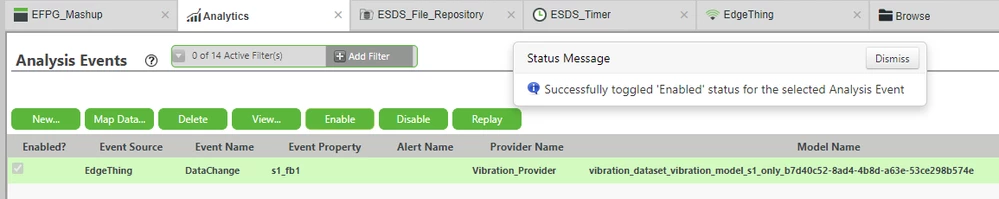

In the last guide, we disabled the Analysis Event after confirming that appropriate analytical jobs were being created and completed whenever new data from our EMS Engine Simulator entered Foundation.
We now need to re-enable that Event so that we can see the results in our Mashup.
    1. Return to Analytics > Analytics Manager > Analysis Events.
    2. Select the Event, and click Enable.
View Analytical Results

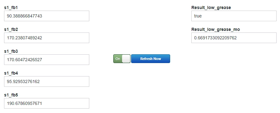

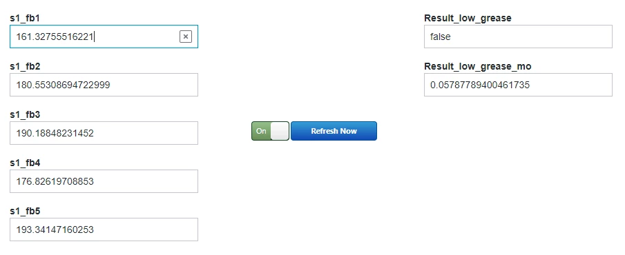

With the Analysis Event enabled, we can now view our Mashup to watch engine-failure-predictions be displayed in real time.
    1. Return to EFPG_Mashup.
    2. At the top, click View Mashup.
    3. Wait and notice how the refresh occurs every second, including both true and false analytics results for the "low grease" condition.
     4. When you are satisfied that you have observed enough true/false results, return to Analytics > Analytics Manager > Analysis Events and Disable the event.
