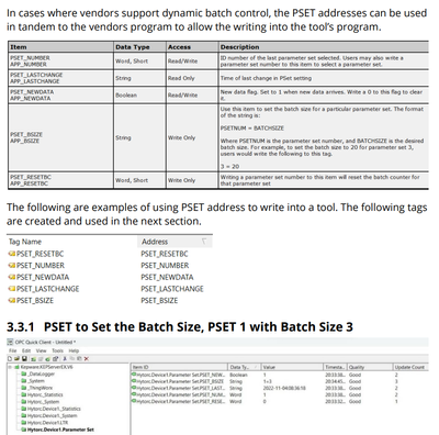

1. Kepserver configured with Channel ->Torque Tool Ethernet Device
2.Device is configured with Controller IP address and Port Number :4545
3.Pinged Atalscopco controller from hosting machine(My Laptop) sucessfull
4.Port Testing Sucessfull
5.Revisonnumbers are configured
6.Atlascopco Virtual station configured
7.Expected Tags will imported automatically - but it was not showing anything
8.And ,when I'm trying to define tags manually getting syntax error
Could you please let me know ,automatic tag import is possible? or Do we need to subscribe ? How to establish the basic communication and R/W data ?
1 REPLY 1
Automatic tag generation is not possible with this driver. You need to configure the tags manually.
You can refer to the driver help file to understand tag addressing.
Here is an example of tag addressing as well. Thanks
