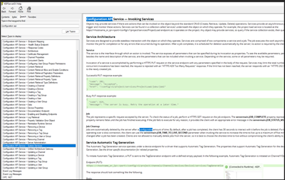

Hello Team,
We want to synchronize two Kepware project Automatically for Redundancy purpose, In PTC Knowledgse base we have checked the  Article CS353352 (https://www.ptc.com/en/support/article/CS353352) Where they have mentioend this below line.
  • Workaround: use a batch script to copy the .opf from one system to another, and then through the Config API call the endpoint to replace the project
For that Your help require if nay sample or example or any reference link is available how to make Batch file for Kepware *.opf file?  As I know this active Backup file run on System Program data Folder. So how we can achieve this requirement?

Hello @cmorehead
Thank you for the update. I have opened case to PTC team case ID: C17323207.
But, I'm having question for this below green highlighted line. Because we have made the Batch script to copy the file from one place to other place.
Workaround: use a batch script to copy the .opf from one system to another, and then through the Config API call the endpoint to replace the project.
How to Call config API from endpoint because I have checked below snapshot but I'm blank how to configure it, if you could help me here to solve this issue. You can create test environment from your end if you demonstrate me then I'll do it myself and learn new thing.
Best Regards,
Bhadresh Rangi
@BRangi
You would need a third-party API Platform application like Postman. Here is a link to Kepware training video that covers the use of Postman with the Configuration API:
Configuration API (youtube.com)
Here is also a link to some example scripts:
Kepware-Example-Scripts/Config API at master · PTCInc/Kepware-Example-Scripts · GitHub
*Chris
Thank you so much @cmorehead  for the support.
