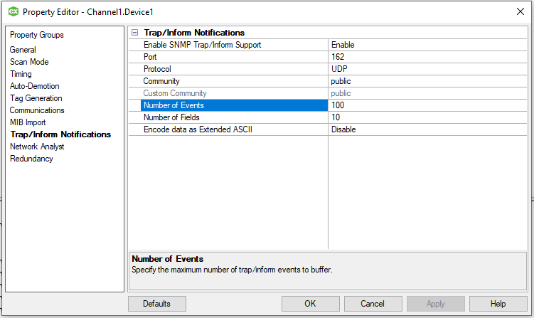

I have a connection with a device through SNMP v2c. By default Kepserver allows me to receive a maximum of 100 trap events, but I need it to allow me to receive 200 trap events. Is there a license that increases the number of trap events?

The device property "Number of Events" is hard coded to a maximum of 100 and cannot be increased. You could put in an enhancement request to see if the increased functionality can be added to future releases of the application. Here is a link to the Kepware knowledge base article that covers how to submit an enhancement request:
