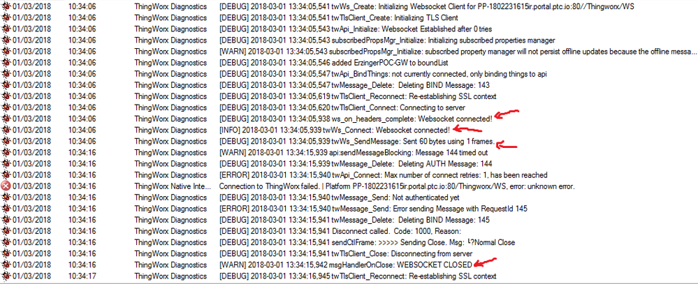

Hi, I am trying to connect to this Machine, but It's giving me unknown error. I started to do logging with debug and this was my output from the kepserv log.
As you can see it connects to the websocket, but right after it ends the connections.
In cloud VMs and my local machine it works fine. But in this client machine it doesn't. I don't know why.
Can anyone help me with this?

Thank you for sharing the Event Log with us, this is helpful. The important message is this one:
Connection to ThingWorx failed. | Platform <host>:<port>/<resource>, error: <Reason>

I find I am able to reproduce the same sequence of log messages you are seeing if I do not have a valid Application Key entered, so I suspect this might be the cause of your failed connection.

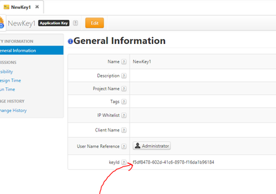

Try creating a new Application key in Thingworx, then copy the keyId string (see screenshot 1).
Screenshot1Screenshot1

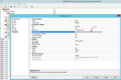

Then, paste the copied key into the KEPServerEX Project Properties (see screenshot 2).
Screenshot2Screenshot2
