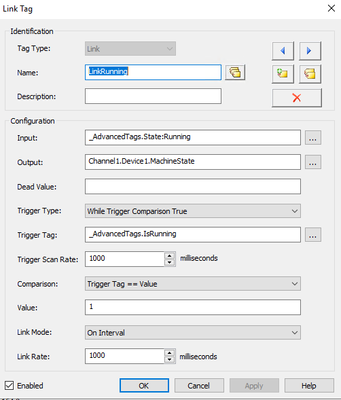

Working with PTC, here is what they helped me figure out:
To get Machine State it required 3 sets of advanced tags:
1. 3 derived tags to identify the state as a Boolean (Running, Idle and Down)
2. 3 derived tags that hold the strings for the states (String tags with values: "Running", "Idle" and "Down")
3. 3 link tags to link the state string to the MachineState tag based on actual state
Here is an image of the LinkRunning tag for reference.
