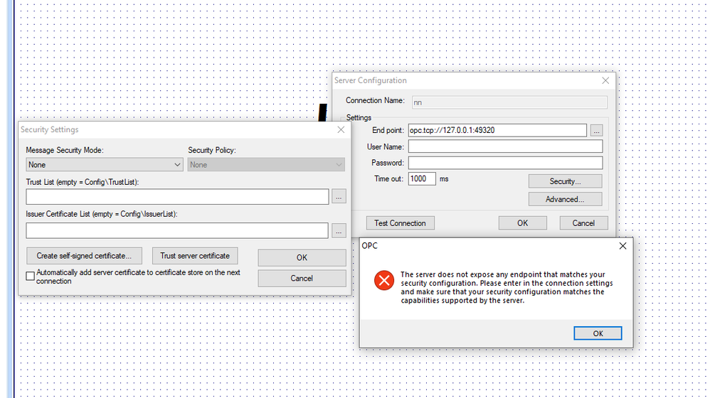

i want to connect kepserver ex6 opc ua whith indusoft 8.1 and i get this error in the last step , can anyone help ? Capture.PNG

The error shown indicates a mismatch between the Endpoint URL's. It's possible the security credentials are not matched. I recommend opening a support ticket with the Kepware team for more in-depth troubleshooting. Here is a link t the login page where a support ticket can opened:

Make sure your endpoint allows the connection/encryption method you are specifying in the client application.
-Andy
