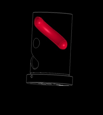

I am using Creo Parametric - Release 7.0 (connected) 7.0 7.0.3.0
I have a round part with a "flow channel" that I am trying to rough out trying to pick mill. My work around is to use 4axis trajectory with full size ball endmills and axis shift tools paths.
Any ideas? I have tried cutline however, Can only get the bottom of the radius pick milled.

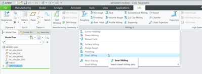

If you do not have above licenses, and/or no plan to move to Creo 8.0 from a short term perspective, you may consider approaching this with a Swarf Milling sequence:
You can also access an outdated, but nevertheless probably helpful because still effective (still accessing Menu Manager in Creo 7.0) suggested technique on this here.
