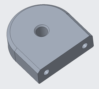

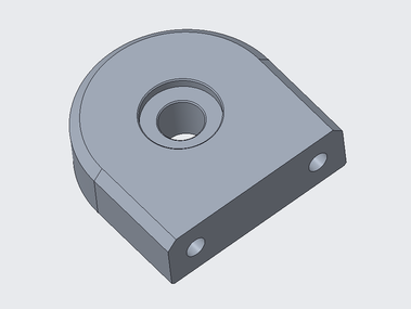

I have a question about manufacturing family parts.

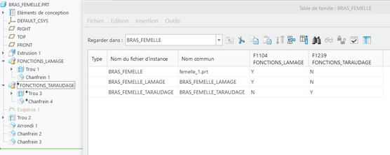

I have 2 parts ruled by a family table. Simple parts, one with a M8 threaded hole and the other with a 8.4 countersink hole. This is the only difference between the 2 versions.
2024-01-15 08_43_42-BRAS_FEMELLE (Actif) - Creo Parametric.png2024-01-15 08_43_56-BRAS_FEMELLE (Actif) - Creo Parametric.png2024-01-15 08_44_28-Table de famille _ BRAS_FEMELLE.png
The 2 versions/functions cannot cohexist in the generic part because the threaded hole and the countersink are both chamfered. The geometry for the chamfer on the threaded hole is destroy by the countersink fonction and vice versa for the chamfer and the countersink. In the generic part ONLY i am forced to desacivate one of the 2 fonctions. No problem with childs parts.
Due to this specification is it possible to have one manufacuring assembly with a "selection " version threaded or version 8.4 ? Or am i forced to have 2 manufacuring assembly with both "child" parts ?

Exactly for the goal. And exactly too for the inefficience of copy all common features in all instance in the same assembly. Above all if in 6 month I want to change a tool or parameters, I will have to remember to change it in all copy.
I tried the solution with having only one model and changing it depending on the desired version but it does not work. When you suppress the machining sequences and change the initial instance for an another it works but when you re replace the initial instance and reactivate its sequences : Error !
Indeed for exemple, in the drilling for the threading, the axis used for the sequence is no longer existant due to the change of the instance. I fix it but same problem when switching to the countersink sequence. Axis does not exist in the previous instance even if the function was not activate. Infinite loop… It seems to creo keep in memory references even if they are suppress and do not like the changement of model…
I think, the most practical solution and the less dangerous is to have one assembly and all the instances including the generic version. All common features will be attached the the references of the generic version and each particular features on each corresponding instance. Family table for pilot instances and hiding with « save status » in the layer tree of each instance.
I can post pro the correct « personalised » G-code on each instance.
Thanks everyone for your help.
Edit : The "save status" in layer tree does not works :D. It save it for all instances... I can't have at the same time instances 1 & 3 hide in model 2 and instances 1 & 2 hide in model 3... The hiding status is the same for all...
