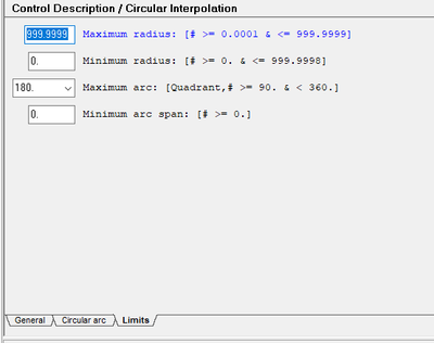

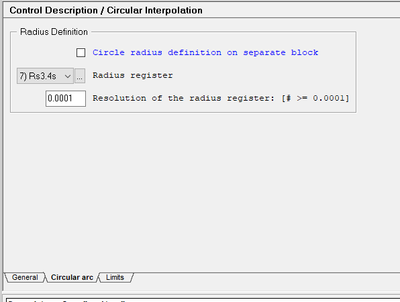

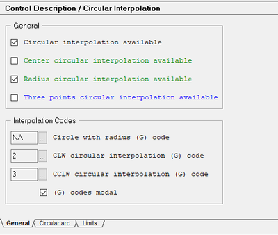

I am using ICAM 23, but I started out at I think it was V14. I have a Fanuc turning post, that was one of the first one I created, and I did a search for Radius and these are the values I get in the database file. Check in "Control Description, Circular Interpolation" tab and make sure Three point circular interpolation is unchecked. and Radius circular Interpolation is checked. Also, make sure you have a Radius Register set. Here are a couple screen shots.
Hope this helps.
