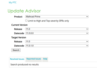

I'm trying to find out what was changed or fixed in datecode 11.0.1.0 compared to 11.0.0.0. If there is a summary of changes/fixes on the website someplace, I haven't been able to find it. I support our company's users and would like to be able to tell them what is changed in 11.0.1.0 before they upgrade their installed version.
7 REPLIES 7
"Bug Fixes" and  below shows no results.

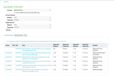

Hi @PaulOrtmann and @ppal ,
Please do check the Update Advisor for the fix in Mathcad Prime date code 11.0.0.0 to 11.0.1.0
The issue of the result not being shown has been fixed.

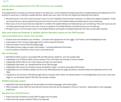

Hi @PaulOrtmann,
You can refer to this Knowledge article:
  • CS132280 How to access Update Advisor on PTC Support website
Note: (We are aware that the list of SPR fixed from Mathcad Prime Date code 11.0.0.0 to 11.0.1.0 are not shown and PTC team is working to fix it)
