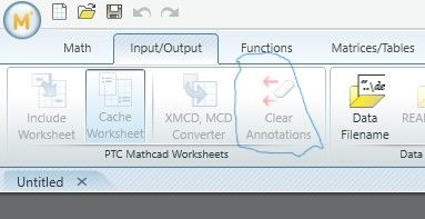

When red arrows are present this is available to clear them.
Cheers Terry
2 REPLIES 2
Cheers Terry
Well, now I'm embarrassed!!!!!   😏
