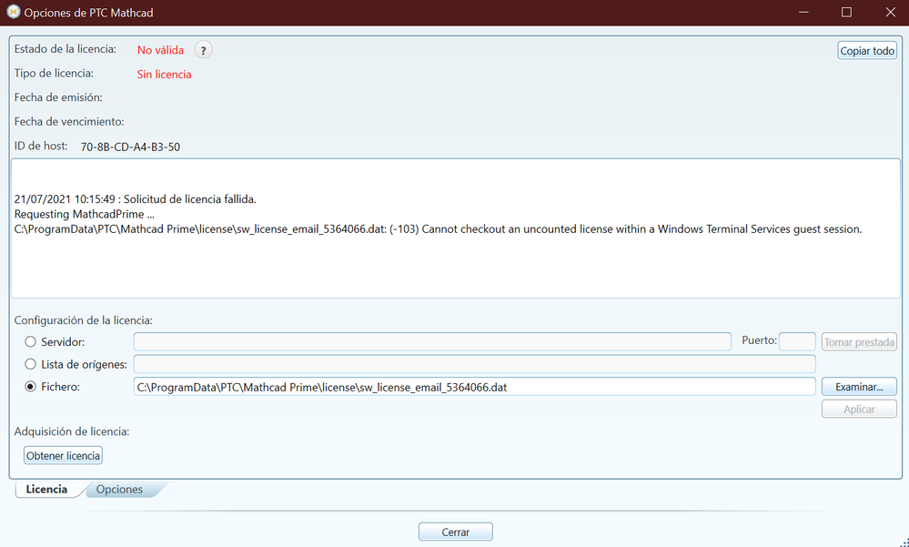

Hello
As you can see in te image, the error message is "Cannot checkout an uncounted license within a Windows Terminal Services guest session"
I wonder if the problem could be that Mathcad Prime is installed on my personal computer at the University, and now I am accessing it from home through the windows remote desktop.
If so, this would be a problem, because I always teach my classes this way, and I take the remote control of my personal computer, from the classroom computer.
Thank you very much
@R2man,
There are two types of licenses:
1. Node locked: Fixed to single machine
2. Floating license: You can install license server on server machine and float licenses to other machines in same domain network.
The license which you are using is node locked type of license. And, the error (-103), Cannot checkout an uncounted license within a windows terminal services guest session is expected when you use Mathcad configured with node locked license remotely (using terminal services like RDP -  Remote Desktop Protocol).
To avoid such error, you should physically use Mathcad on same machine where it is installed and configured with node locked license. Or, if you want to use Mathcad remotely then, you must purchase floating type license.
R2man
(To:rghadge)
Thank you very much.
Indeed I have verified that the origin of the problem was to access my computer at the university where I installed MathCad remotely from home (now I am physically at the university and there are no problems with the free 30-day license).
The need for Mathcad is uniquely individual, and to have it installed exclusively on a single personal computer, but I would like to be able to use it remotely from any classroom equipped with a PC on which Mathcad would not be installed.
I suspect that a floating license is not a valid solution, as it would require installing Mathcad on each classroom computer, which I am not allowed.
I have verified that if I run Mathcad from my office before going to the classroom, and later take the remote control from there, everything works perfectly.
