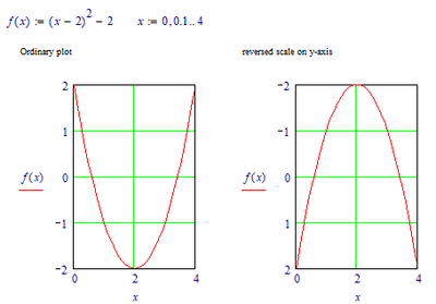

This is what the OP wants (the plot to the right), as I understand it:
This is easily accomplished in ANY version of Mathcad

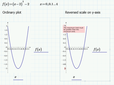

It's just NOT supported by (any version of) Prime, because Prime refuses to set the upper y-axis scale limit to a smaller value than the lower limit:
