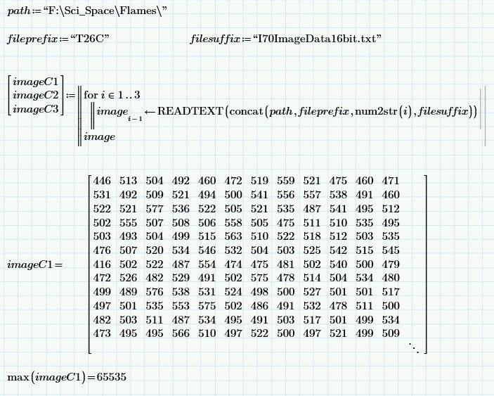

Put the files into one directory.
Scilab commands to read the files, convert to doubles, and save to text files are simple.  This gives larger file sizes.
To use binary files is possible with a few more statements than this.  Doing thousands of photos I would use binary to save space.
The variables from these statements look like this
The files are like this.
Can read the text files with Prime.  If used Prime can also read binary files.

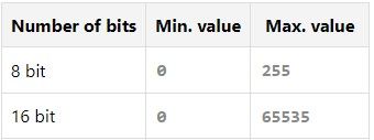

The value of the maximum in the file is the maximum size of an unsigned integer
Zipped up the three text files
