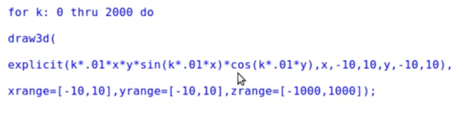

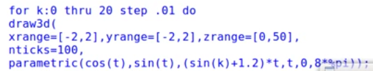

The first animated plot that I want to create is of a spring moving. The wxMaxima code for this is shown below.
This creates a 3D plot of a spring that is stretching and expanding.

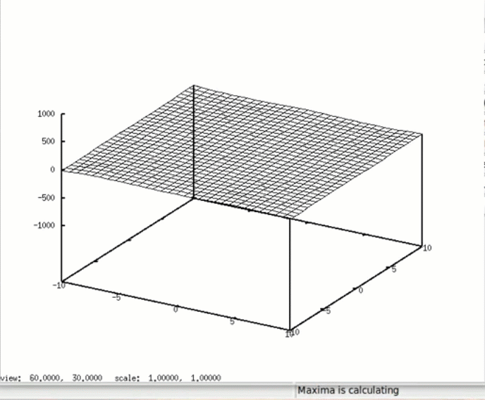

The second animated plot that I want to create is a vibrating sheet. The wxMaxima code for this is shown below.
The animated gif is shown below.

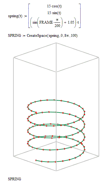

Here is the spring with some slight modifications
 FRAMES from 0 to 200, 35 frames per second

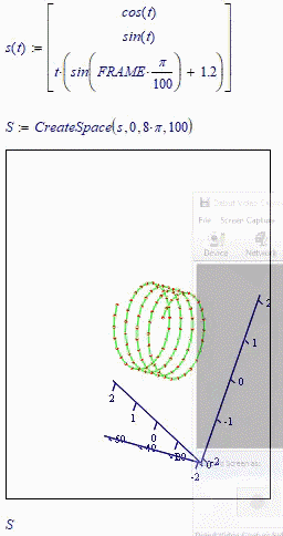

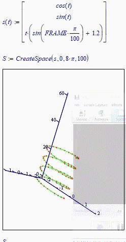

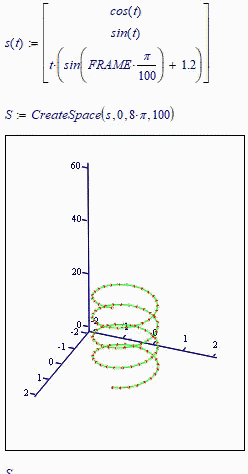

There's another type of animation possible with (real) Mathcad: you can rotate a 3D plot:
LM_20210208_SpringRotate.gif   LM_20210208_SpringRotate2.gif   LM_20210208_SpringRotate3.gif
To show it here, I had to capture a screen-video, and convert that to an animated gif. Both with other software.
Enjoy!
